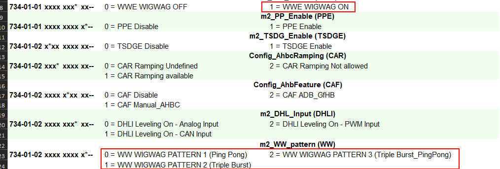

I was never able to find any settings for the wig wag.
HCM
Ford F-150 Lightning Enabling Wig Wag? WW_HCM
But you'd need to locate this mysterious Pin #1 in the white connector supposedly in the center console area (on PIU or SSV vehicles I imagine). I own an old 2010 SSV Expedition and it had a police upfitted center console that was removed before I got the truck. So I'm not sure where this connector wire (Pin #1) would be on our consumer grade trucks...I know it starts out at the BCM though. So the relevant output pin would just need to be grounded to enable the WW function whenever you needed it.
