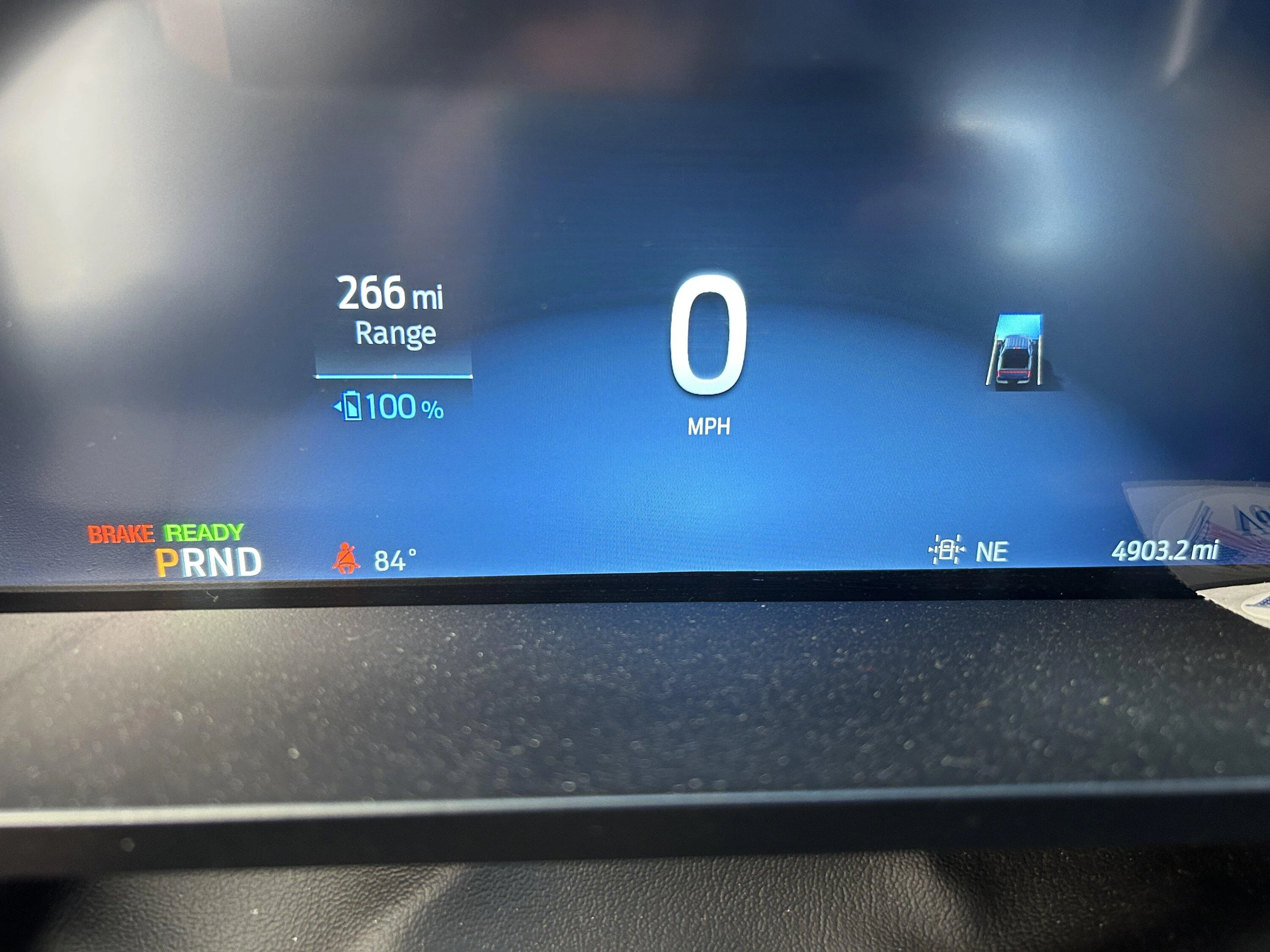

35 degrees is extremely frigid for me as I live in So Calif where temps never drop below 50, so it's all relative.
Just to compare, this last week of November, I am getting 15-25% ABOVE EPA range estimate (remember, the GOM is an estimate) because I am in 80 degree temps and NOT running A/C like I had to last week.
A/C does have some impact on range but not as much as heating.
BTW: people here are not condescending - they are seasoned peers that hear about cold weather "Shrinkage" a lot year after year. I am forum moderator on other sites & FB so i get to hear about it every fall.
EPA range lists 230 miles on my SR - it's been normal for me to get 260-291 miles of range. This was this past weekend:
