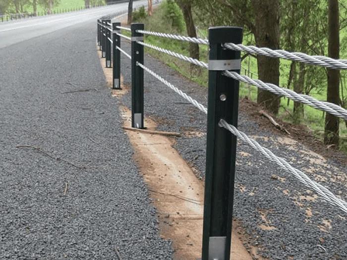

I'm all for getting rid of cable slice & dice railings.
