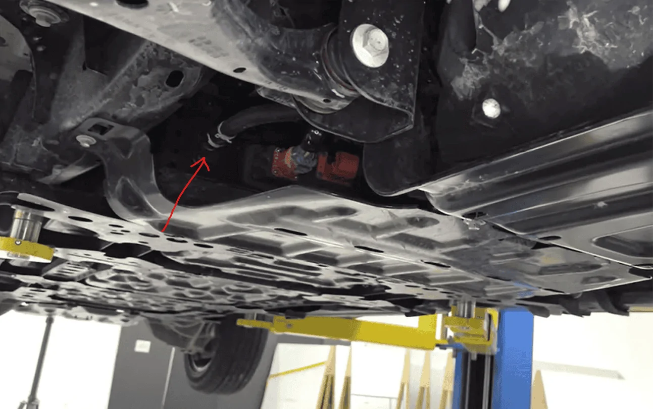

Looks like the exact same thing that happened to me. As I said in the thread, my dealership said it's possible that the pack would need replaced, but I was fortunate and it didn't. This guy apparently wasn't as fortunate. I went out and took a quick (bad and out of focus) pic of my skid plate where that gap is and you can see where much of the paint has been worn off by debris and can also see both the HV and coolant connectors in the gap.
Wow, thanks for the shot... so have you (or others) figured out a skidplate or other solution for this? Wonder if Ford is aware of this Achilles heel... :(
Thanks again for posting this
-Zap

Figured I would add my truck to this thread to keep it going. I work on a lot of service roads, and my truck started throwing error messages like crazy and reducing available power. Luckily, I was only about a mile from home when it started happening. I had it towed to the dealer, and they refused to fix it under warranty. They claimed the undercarriage had a lot of scratches and scrapes and said off-road use isn’t covered (It does, some of the trails are rough but I always take it slow).
It took them a few days and $2,200, but I finally got it back. They had to drop the battery pack to get inside and replace a $20 plastic part (which attaches from inside the pack). They also told me they “don’t recommend these trucks for off-road use.”
If anyone has ideas on how to fix this obvious flaw, I’m all ears. The strange thing is that I had already been back on the freeway for about 20 miles when it started acting up. I had been working at a cell tower up a mountain earlier that day, though.
