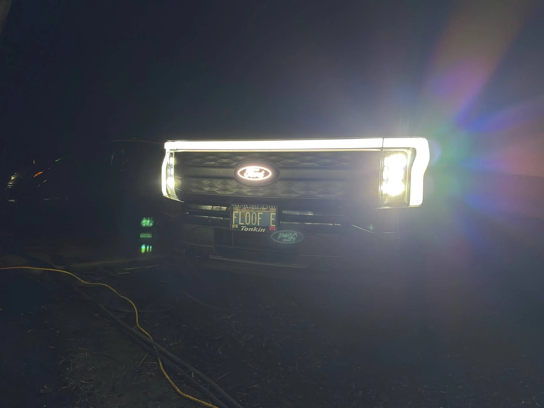

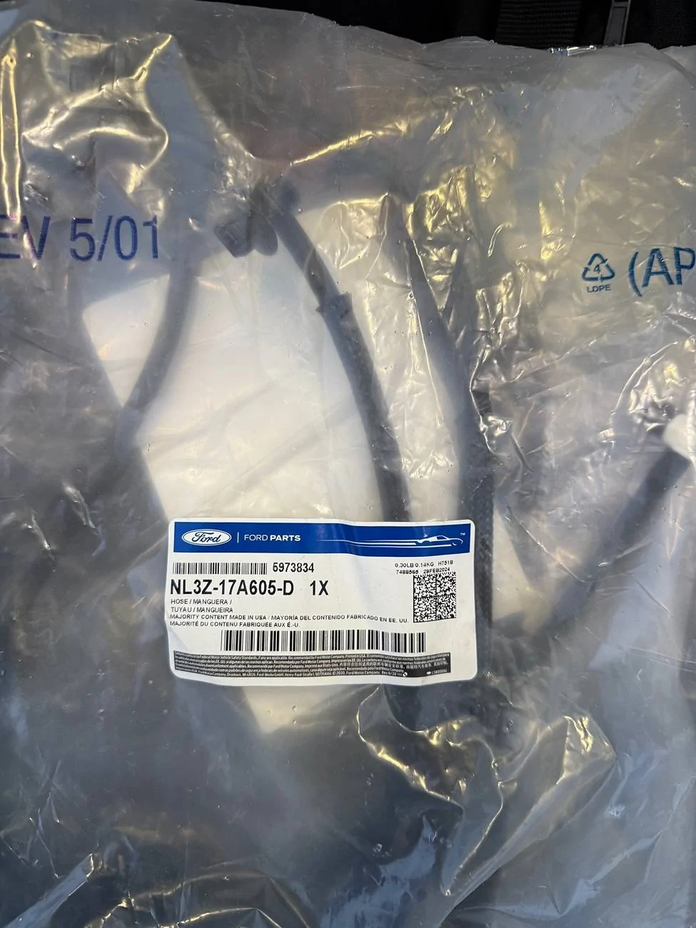

I’ve installed the emblem. I will do a write up in the next couple weeks. So you do have to swap out the wires on the harness. Using the harness is a lot cleaner than the fuse box. As well I will be adding the camera washer back and the parts guy found me all the parts I would need. The most important part though is the hose which I would rather a factory one then parts slapped together at Home Depot. This is the house part number if anyone is interested. I’ll post the rest of the part numbers when I do my write up.

I was gonna do a write up but have been so busy. I swapped the black and red wires like the video said and then routed the wire through the rubber wire harness housing on the frunk lid that way all the wires are hidden. I had no interference with the radio as everything was done through drivers side.

I did the camera washer. You can just buy the oem hose and everything is plug in play. No modifications needed. Also it’s better to route wires through drivers side as there is no radio interference that way and a cleaner install as there is a rubber harness housing and you don’t see any wires
