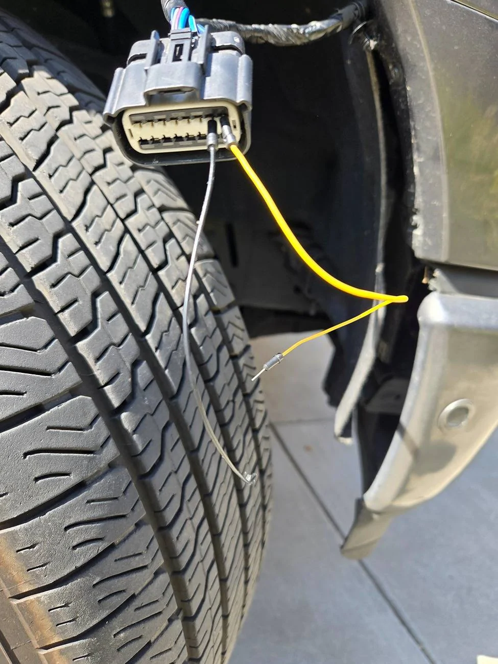

How do you access the headlight harness that the modified putco harness plugs into? Can you reach it from the frunk sides once they are removed?
I answered my own question. It is best accessed from removing the felt right above the wheel.

I found it’s easier if you remove the plastic trim around the frunk. When you take the plastic off, the headlight harness is right there
I actually did both, but found it was easier to get to above the wheel.
The yellow wire in the photo certainly is the 12 volt supply to the headlights. It appears that the black is ground, as has been mentioned in YouTube videos. I have not yet found which wire controls the parking lights.
