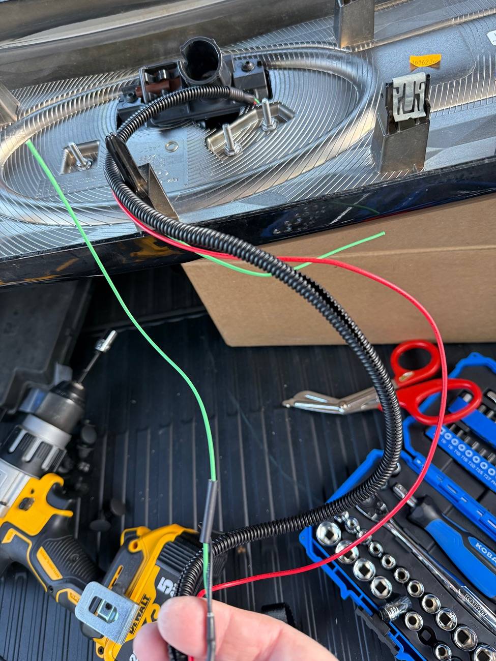

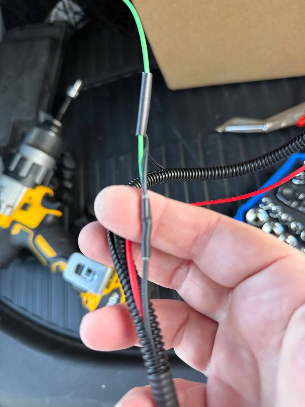

Just completed my install!
Fuse 137 as someone suggested, 20A fuse on bottom, 5A fuse on top of the fuse harness. Yes, you need indeed both I guess.
And below the green hidden wire that has to be connected for the animation to be enabled.
