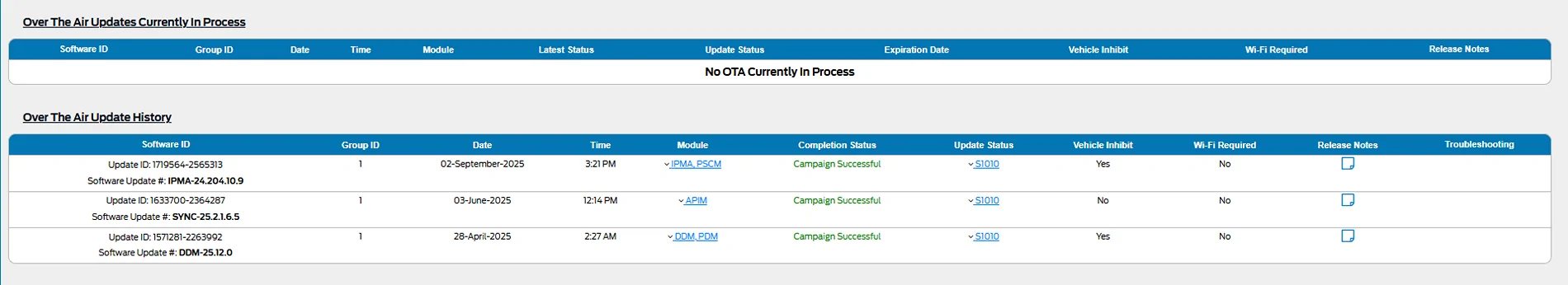

Got your message. Strange that it appear as a no-name update. OTA dashboard shows it is the regular BC 1.4 update every one gets.
The no name OTA might be because the APIM is in Norwegian?
