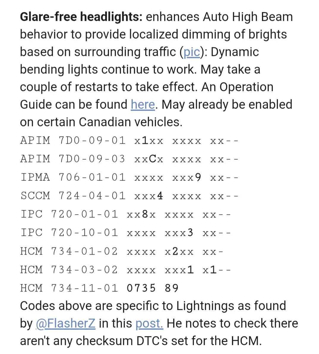

Edits: Bruce is helping me prepare this Glare-Free for Dummies Post a/k/a The Complete Idiot's Guide to Glare-Free which is what I always need. Still have more to add and number them later.
Modules affected:
APIM = Sync Screen = To reboot it you have to connect to Forscan on your laptop and click on the square wrench button on the left side.
IPC = Dash Screen
IPMA = Image Processing Module A = The camera behind the windshield.
SSCM = Steering Column Control Module = Tells the system the direction you are steering for headlight bending.
HCM = Headlight Control Module = Probably controls what particular led's are turned on and off inside each headlight along with working with the steering control module to make them move when oncoming cars and cars directly ahead of you are detected. Probably makes the headlight led's that look to the ditches stay on.
Glare-free headlights: enhances Auto High Beam behavior to provide localized dimming of brights based on surrounding traffic (pic): Dynamic bending lights continue to work. May take a couple of restarts to take effect. An Operation Guide can be found here. May already be enabled on certain Canadian vehicles.
APIM 7D0-09-01 x1xx xxxx xx--
APIM 7D0-09-03 xxCx xxxx xx--
IPMA 706-01-01 xxxx xxx9 xx--
SCCM 724-04-01 xxx4 xxxx xx--
IPC 720-01-01 xx8x xxxx xx--
IPC 720-10-01 xxxx xxx3 xx--
HCM 734-01-02 xxxx x2xx xx-
HCM 734-03-02 xxxx xxx1 x1--
HCM 734-11-01 0735 89
Codes above are specific to Lightnings as found by @FlasherZ in this post. He notes to check there aren't any checksum DTC's set for the HCM.
I might add that there is no capital letter O "O" used in the code. Those values are a Zero "0".
Step by step instructions to run more than one module in Forscan.
Turn on the pickup without pressing the brake and connect the cable to your pickup at lower left.
Run Forscan on your computer and plug in the cable.
Click on the cable/chain link button at lower left to begin link and it show linked.
If at anytime you get a Error popup that says the OS Workstation. No ServicePack that refers to the module name with Forscan\forscan.exe and then lists some application data, then do not bother to click on the copy text button or the OK button, which will cause forscan to crash, but instead click on the minimize dash at the top right of the box and leave it all the time you are using forscan.
Might add that after this or the next step you will get a warning popup about the following conditions being met such as ignition key is on, etc. Go ahead and click on the OK button.
You may also get a warning popup in the process about the Adapter is not optimized for maximum performance and adjusting the baud rate (which helps to show how super old the program is). Go ahead and click on the Yes button.
Also if you previously saved a profile using forscan you may get a feedback needed popup saying it found the prior profile(s) and would you like to use them? Since you are dealing with modifying the profile in the vehicle now you would want to click on the No button. I suspect if you clicked on a previous profile you could only modify the profile itself or use that profile to restore your vehicle back to how it was with that profile (which is why a save is done after each change).
Click on the Download Vehicle Information big I square button on the top left and it will download the vehicle data and list all the modules.
Once you open the module and before you change anything, click the SAVE ALL button at the bottom. Forscan will auto name the file with the module name and date/time. You can typically add to the file name such as "BEFORE glare-free" for example. If it is the very first time then same a copy as something like "As Built from Ford", etc.
After all the modules have downloaded click on the module (as built) that you want to change
Click on the Program square button which looks like a sideways S in a sideways square box under the wrench icon square to bring up programming mode.
At some point you will get a warning popup that says changing configuration is potentially not safe and to make an as built ABD backup then go ahead and click on the OK button.
Click on the module to change using the "as built" module".
Click on the green arrow button at the bottom left to bring up module contents.
Click on OK on the popup for changing configuration warning.
Make changes to the values in the command lines for what you are doing and make sure you write down what the prior value was before making that change. You may be making changes in more than one line and have to scroll down to find it.
When done with changes to the module then click on the write all button at the bottom.
At some point you my may get a warning popup for incorrect checksum of data entered asking to continue anyway. Go and and click on the Yes button.
You will also get a warning popup about Module configuration (as built) that says it will completely rewrite the module are you sure? Go ahead and click on the Yes button.
When you get a popup that says Block program successfully - cycle ignition off & and back on then go ahead and push your ignition button off till the lights go out and push back on and then you can click the OK button on the popup.
Then click on the square to the right of the green arrow down at the bottom to get out of programming mode for that module.
If you need to program another module then click on the download vehicle information square button at the very top left and click on a new as built module and click on the green arrow to start the process again.
Once you are ready to quit after you are done writing, have cycled the ignition off and on, and clicked on the square button to get out of programming mode then go back and click on the Download vehicle information button on the top left and view everything to make sure it is all green arrows.
Once you are finished, click the SAVE ALL button at the bottom. Forscan will auto name the file with the module name and date/time. You can typically add to the file name such as "After glare-free" for example or "After whatever changes made".
Then click on the disconnect cable/chain link at the bottom to the right of the connect chain link and you can unhook your cable and may need to cycle the truck a couple times or more for changes to work.
Sync reset = May be needed it Glare-Free doesn't run right when done. It may not hurt do it after you have finished and saved your changes and disconnecting. Click on the APIM "as built" module that was previously updated and then click on the square wrench button icon on the left to start the reboot process.
More ways to do a sync reset from Bruce:
1. Hold down the steering wheel volume button on the outer far left side of the steering wheel lower row under the cruise button and also hold down at the same time the right arrow button on the outer far right side of the steering wheel lower row until it reboots.
2. Disconnect the negative cable from the battery in the back of the frunk for at least a minute to reset everything. 10 mm wrench needed.
3. If in FORScan, then click on the APIM module and the wrench Icon to do a module reset.
Here are my codes before I started on my 2025 Flash:
APIM 7D0-09-01 6317 4A28 FECB
APIM 7D0-09-03 0440 0004 0732
IPMA 706-01-01 8E50 A055 AE90
SCCM 724-04-01 2842 0000 9A
IPC 720-01-01 0F0A 1064 D086
IPC 720-10-01 1B08 0021 007C
HCM 734-01-02 0001 0100 0040
HCM 734-03-02 111E 1801 0088
HCM 734-11-01 B159 57
Here are the changes I made from above with x being a number that isn't changed. The changes would be the number or letter in place of the x. The - is computer generated:
HCM 734-01-02 xxxx x2xx xx--
After performing all the changes on mine I am listing the codes when I rechecked them and hopefully did everything right. I note that my manual change of the one number on a line caused different codes to show up in the last one or two places where the dashes were on some of the modules.
APIM 7D0-09-01 6117 4A28 FEC9
APIM 7D0-09-03 04C0 0004 07B2
IPMA 706-01-01 8E50 A059 AE94
SCCM 724-04-01 2844 0000 9C
IPC 720-01-01 0F8A 1064 D006
IPC 720-10-01 1B08 0023 007E
HCM 734-01-021 0001 0200 0041
HCM 734-03-02 111E 1801 0189
