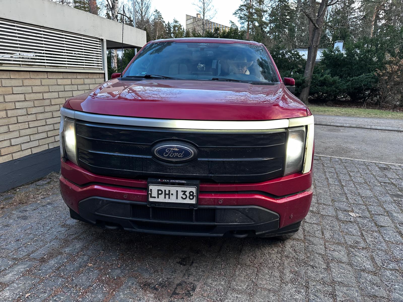

I want to disable the white LEDs around the headlights that continue as an LED bar. The reason is that one headlight is damaged in terms of that LED light and flashes from time to time. The LED bar in front of the frunk can be disconnected, but can ForScan turn off the ones around the headlights when the headlights or DRL's are on.
Ford F-150 Lightning F150 Lightning FORScan thread - Version 2 PHOTO-2025-12-24-12-28-48
Kari
Dec 28, 2025
Finland
F-150 Lightning 2022 ER Platinum
Investor
Don't recall seeing anything related to it in Forscan. Probably better to just unplug it from each light.
Thanks. I need to check if I can remove the LED section from the headlight separately. At a quick glance, it looks like there is only one connector to the headlight that controls both the headlights and the DRLs. I assume that there is a pin in the connector that controls the LED light, but I'm not sure if it can be blocked. I may just have to wait for a new headlight from Ford (or buy one from eBay or similar).
