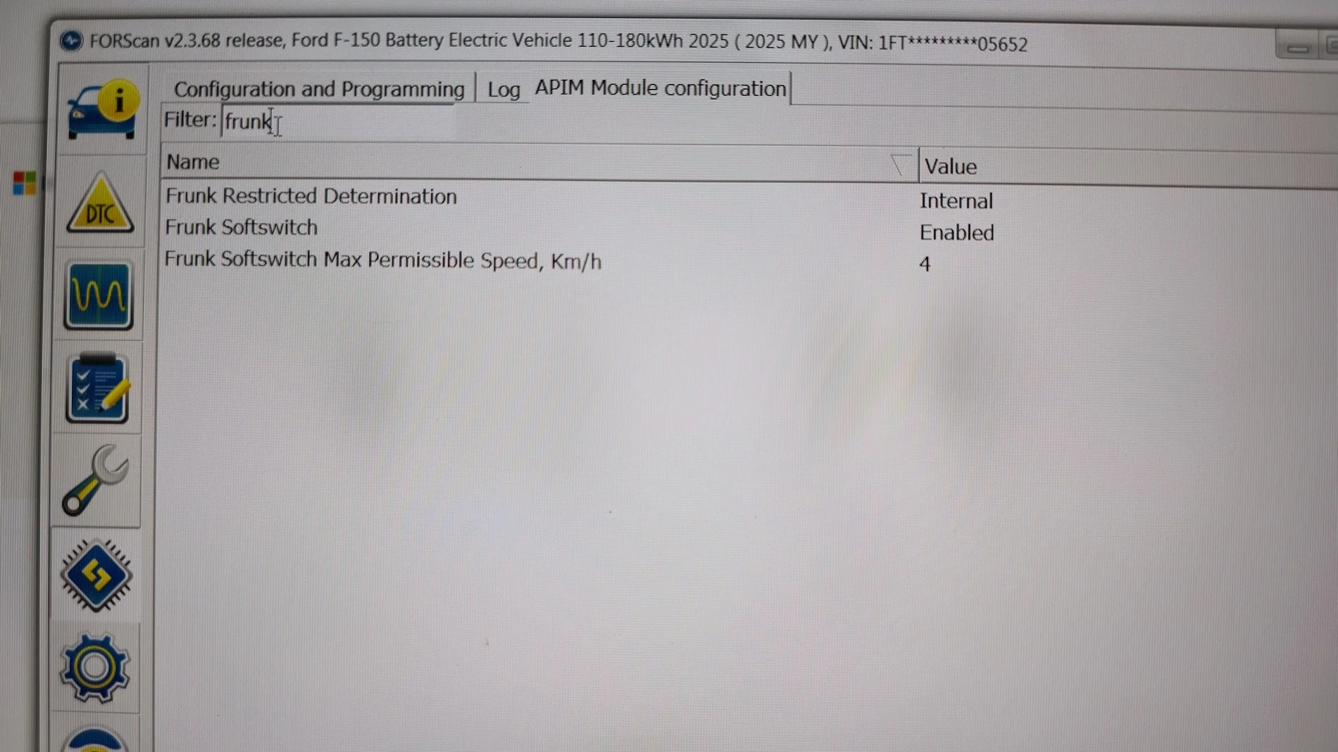

I definitely need to speed up the frunk opening/closing speed. I often skip using it because it's so slow. I missed what needs to be changed in ForeScan to make this happen. Where do I access the speed and how do I change it?
3,268
4,759
It was mentioned a couple pages back. Be careful.
i did see it a couple pages back, there’s where I found out about it. Just wasn’t sure where to change the setting. I’ve only used as built but I guess it’s just in the Easy mode?
I saw your concern posted earlier too, when you say be careful here are you talking about possible extra stress on the mechanism and possibly the pinch sensor not working? Has this been substantiated or still just a working theory?
