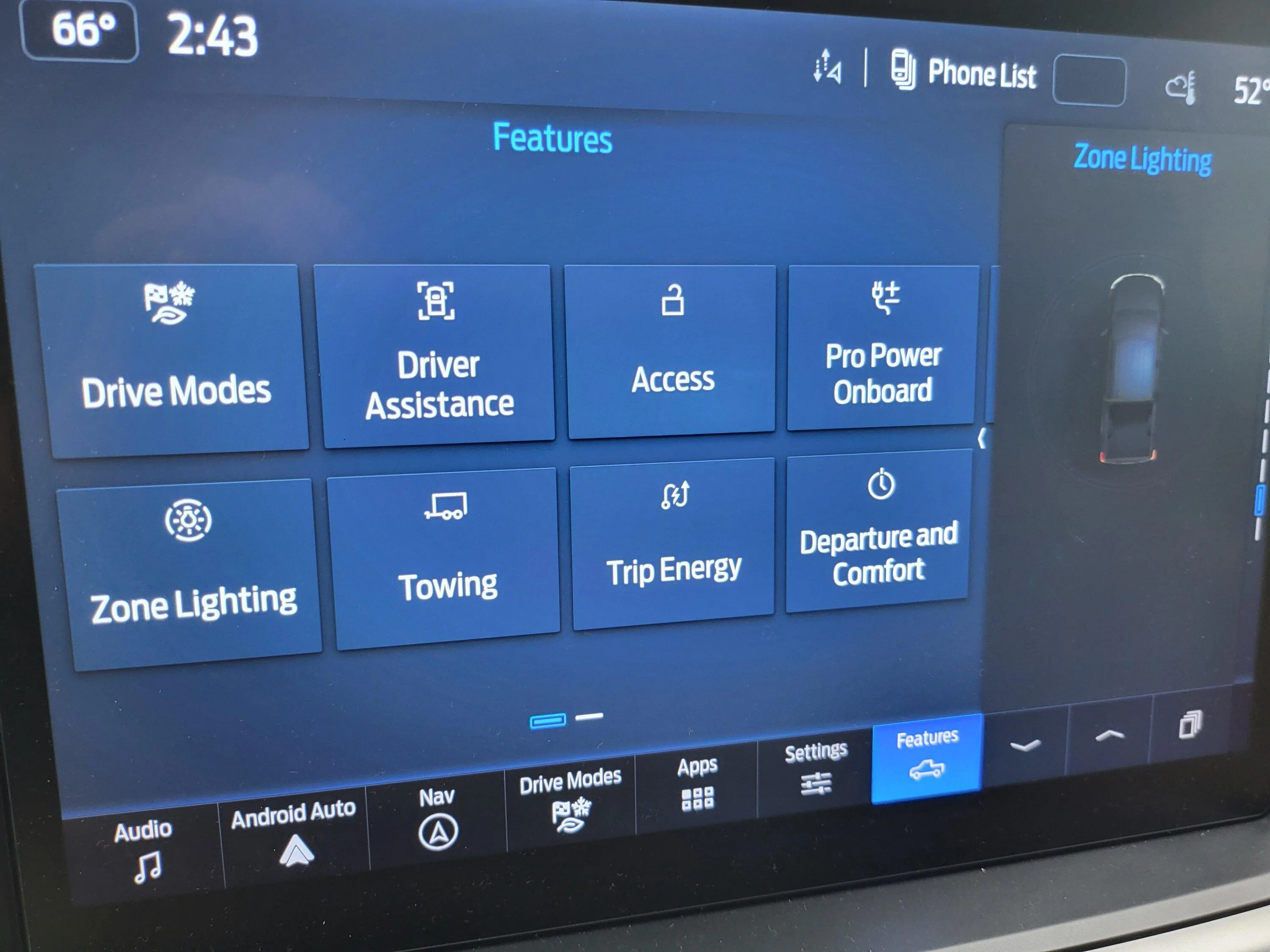

Unless I’m totally missing it in the menus, my 22 Pro (with tow tech) does not have zone lightning.
BennyTheBeaver
Jun 18, 2021
2,245
2,461
2023 Lightning XLT ER
Hmm, I have a MY23 with Max Tow and Tow Tech.
