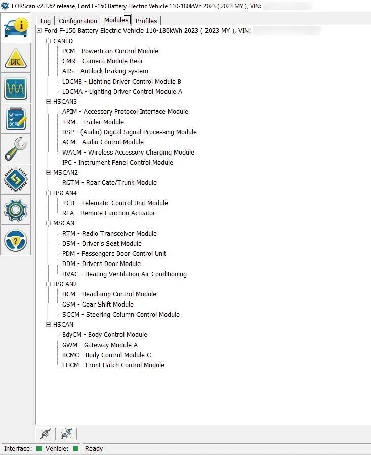

I'm stumped. Back in July, I was in the IPMA module enabling the Trailer Side View, I reverted back the setting to re-enable my Controls Menu for the driving modes. Now I'm going back to see if Enable Cameras at Speed will help me see the cameras when I drive above 5 MPH.
The issue is now I don't see the IPMA module in FORscan v2.3.62 and I'm wondering if anyone else is having this issue or if i missed something greater going on.
Here are the list of modules in the Vehicle and Interface Information section of FORscan:
Ford F-150 Lightning F150 Lightning FORscan thread Ford_Lightning_Module_List
Also here under the Configuration and Programming section of FORscan:
Ford F-150 Lightning F150 Lightning FORscan thread Ford_Lightning_Programming_Module_List

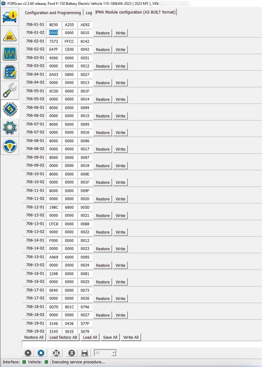

I know I have had it before because I took this screenshot during the process of making the original modification in FORscan v2.3.60:

Try rescanning. When you do the initial connect don’t choose an existing profile. This forces it to scan for all possible modules.
When you chose a profile it only looks for modules it found before. Maybe your profile got messed up.
Are you using one of those adapters where you have to switch buses to see everything? That's the only thing I can think of from what others have posted on the ICE forum when this happens.
Ah, I wonder if that was the issue--thank you. I'll keep that in mind. I uninstalled and went back to the previous working version and it worked (I bet only because it did a full scan as you mentioned.). I hate not knowing the reasoning and just a "reboot" is not how I like to troubleshoot but I was needing to make progress (it was my day off ?).
No, I have the OBDLink EX.
