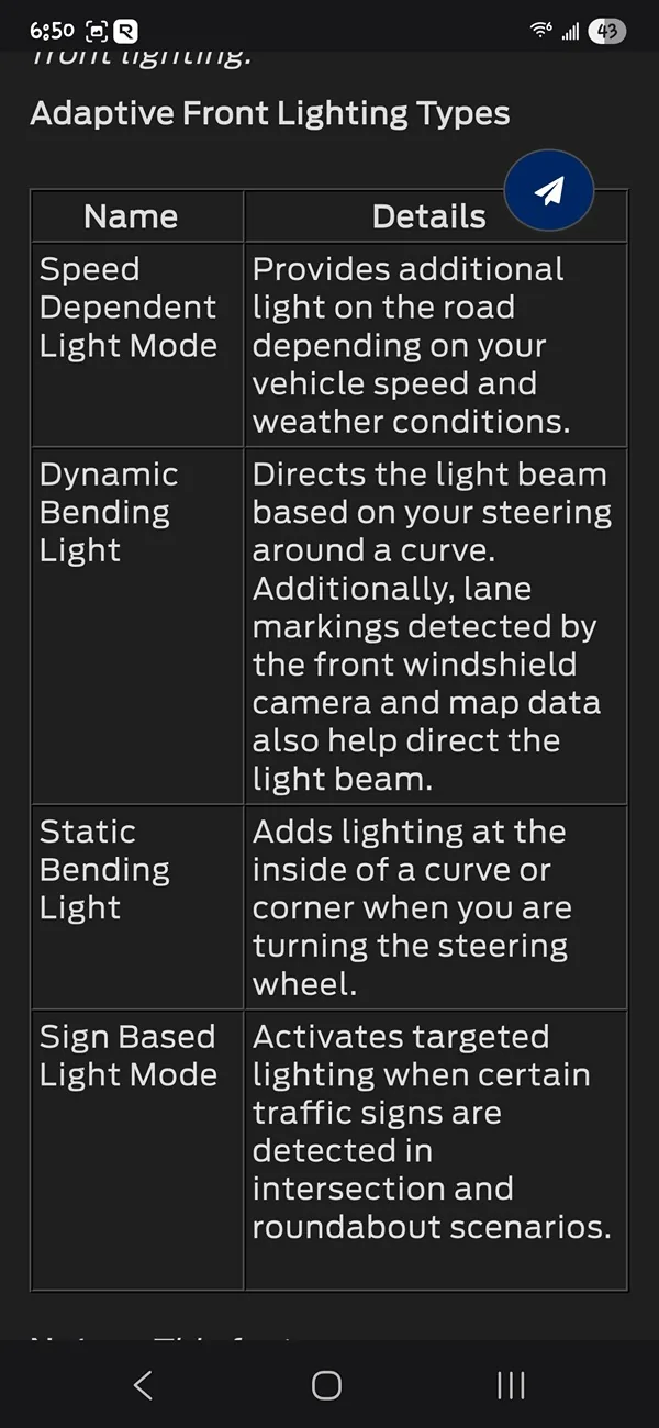

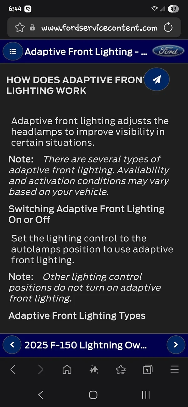

Dynamic headlights auto adjust on start up I thought I read in the manual, now I gotta go look again lol.
Think I found it, called adaptive lighting... I see it every morning they follow the turns I make as well, thought I was losing my mind 1st time it happened, I leave it on auto. Correct me if this isn't what's being discussed.
Yes, but... not all Lightning trims have auto-leveling (up- and down- leveling) headlamps which is probably the reference in the posts above. My XLT does not, although its LED headlamps do swivel left and right slightly on turns.
There are mounting holes for this feature on the upper control arms... the higher trims have extra linkage there to do this up- and -down- auto level function. My XLT does not have this linkage. I know this because it sure made the OEM - to - Eibach shock swaps easier for me two months ago.
