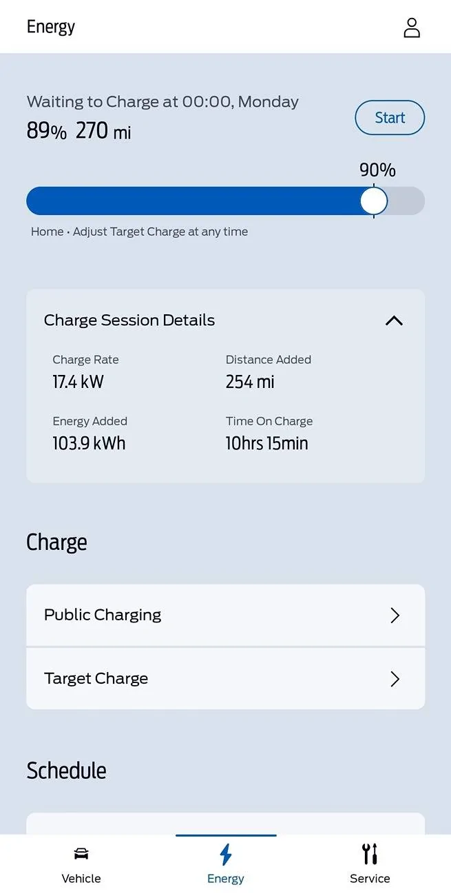

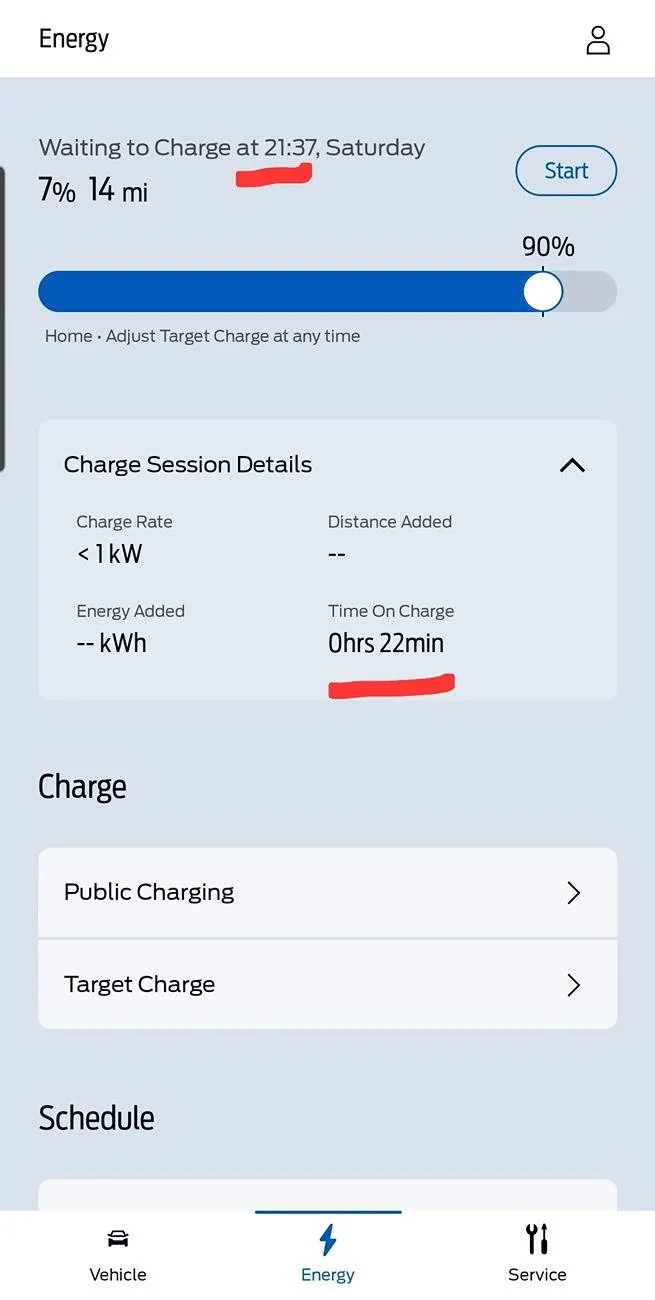

So i plugged the truck tonight when I got home. My preferred time to charge starts at midnight. All good the fordpass app shows the truck is waiting to charge. Nothing new. Although I don't know why it says "waiting to charge @" the time I plugged it. To me it should say "waiting to charge @ midnight". Also I'm not a fan of the charge timer being started.

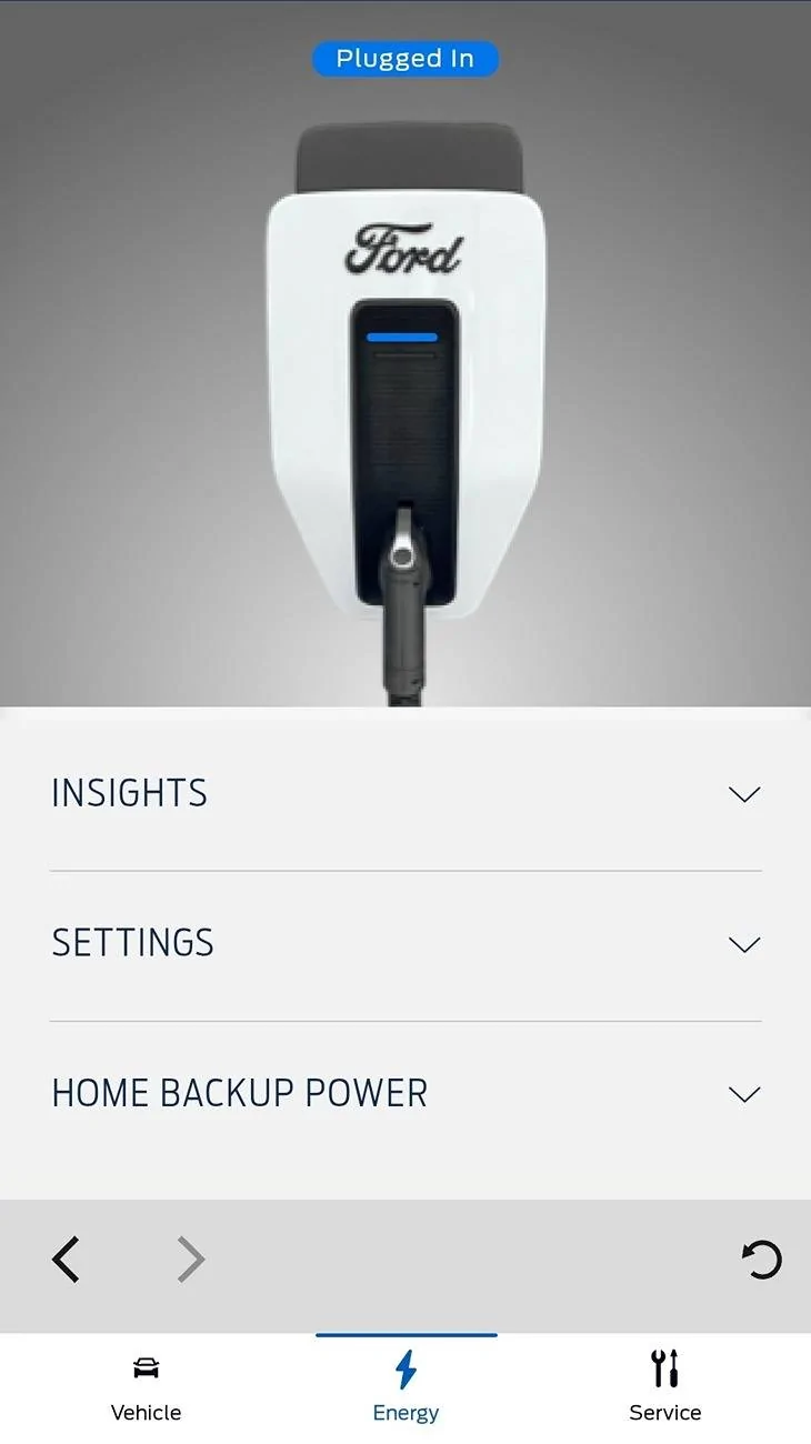

Anyways, I go back outside after a while and to my surprise I keep on hearing the FCSP clicking. Like when it starts charging but then another click like it stops charging. And a few seconds later same thing, on and on.... I never noticed that before so not too sure if it is normal. Will see if the actual charging session will go as usual. But I'm wondering if you guys experienced that behavior?
Light on the FCSP is full blue not blinking.

When I was using restricted times, I usually only heard the clicking of the FCSP once right after initially plugging in the truck, I figure the systems are talking to each other to confirm all is good and ready to charge at the designated time.
How did the charge session go last night?
If the clicking persists, try a power cycle of the FCSP, and the 12v battery in the truck to reset all modules.

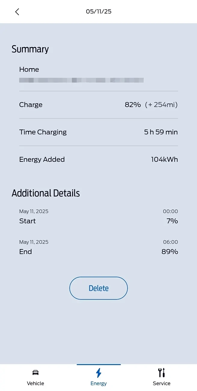

Clicking stopped on its own last night. I went to check one hour later and nothing. Charging session started as expected and ended at 6am which is my preferred end time. 90% SOC was supposed to be reached by 530am but I guess it didn't happened as I'm at 89% after 6 hours charging.

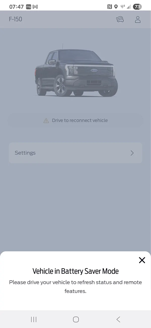

Now this is what I got this morning in the App.
Ford F-150 Lightning FCSP making clicking noise Screenshot_20250511_074715_FordPass
Never had that before as well. I had to unplug the truck and just start it. Everything went back to normal. I checked the LVB soc and it is at 83%. Was 100% 2 weeks ago and 80% a month ago. So I guess it just fluctuates depending on your truck usage.

This would be a symptom of the LVB getting weak, might be time to look for a replacement.

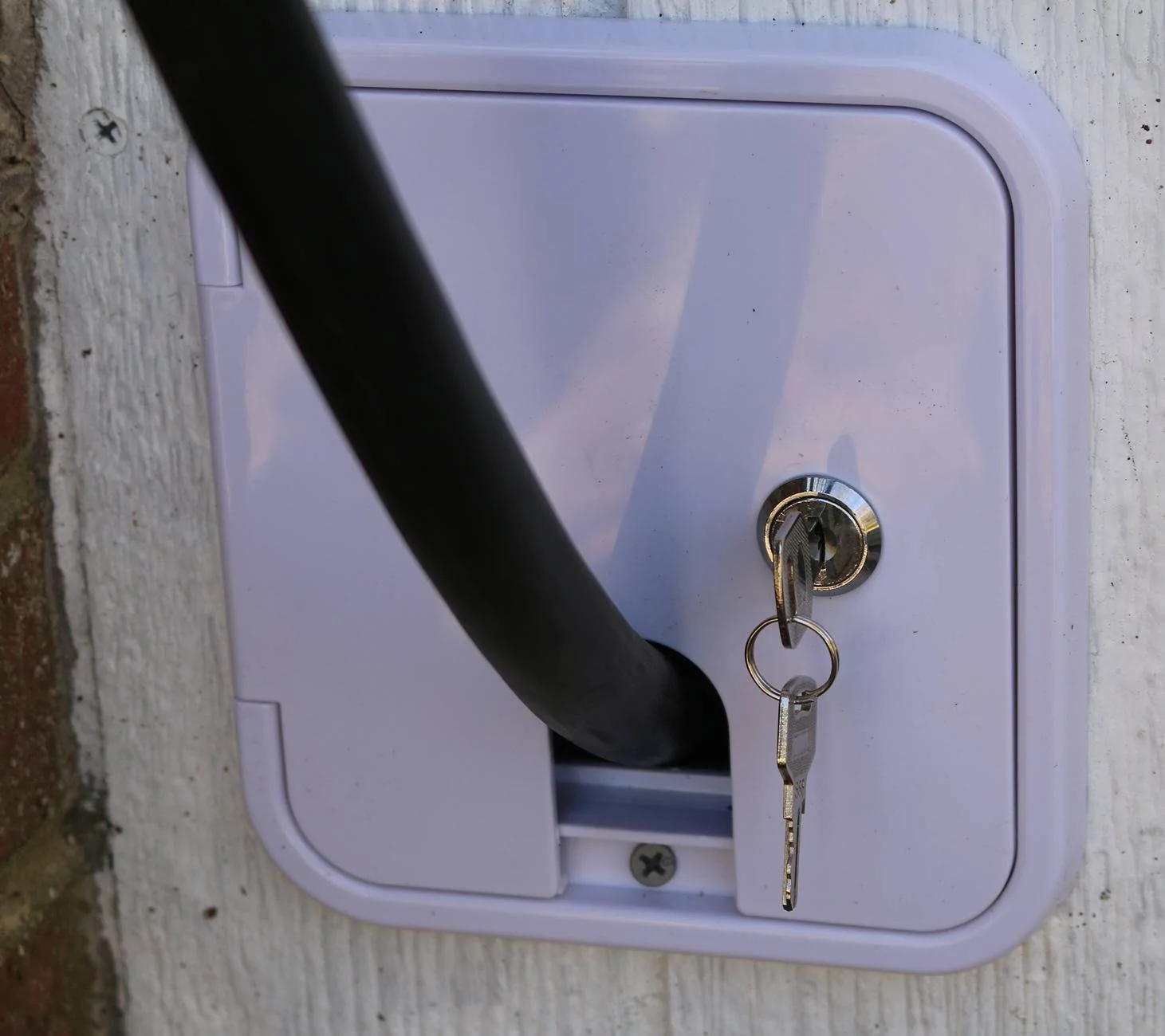

Now I have the charge cable run through an RV access door I put in my garage side panel, so I can keep the garage door closed and locked while charging - my truck doesn't fit inside the garage with the Leaf in there - so I could not hear the clicking if it was happening.
Ford F-150 Lightning FCSP making clicking noise IMG_5793-cord pass-through
And I am usually not around the FCSP or the truck at 1am when I have the charging set to begin.
