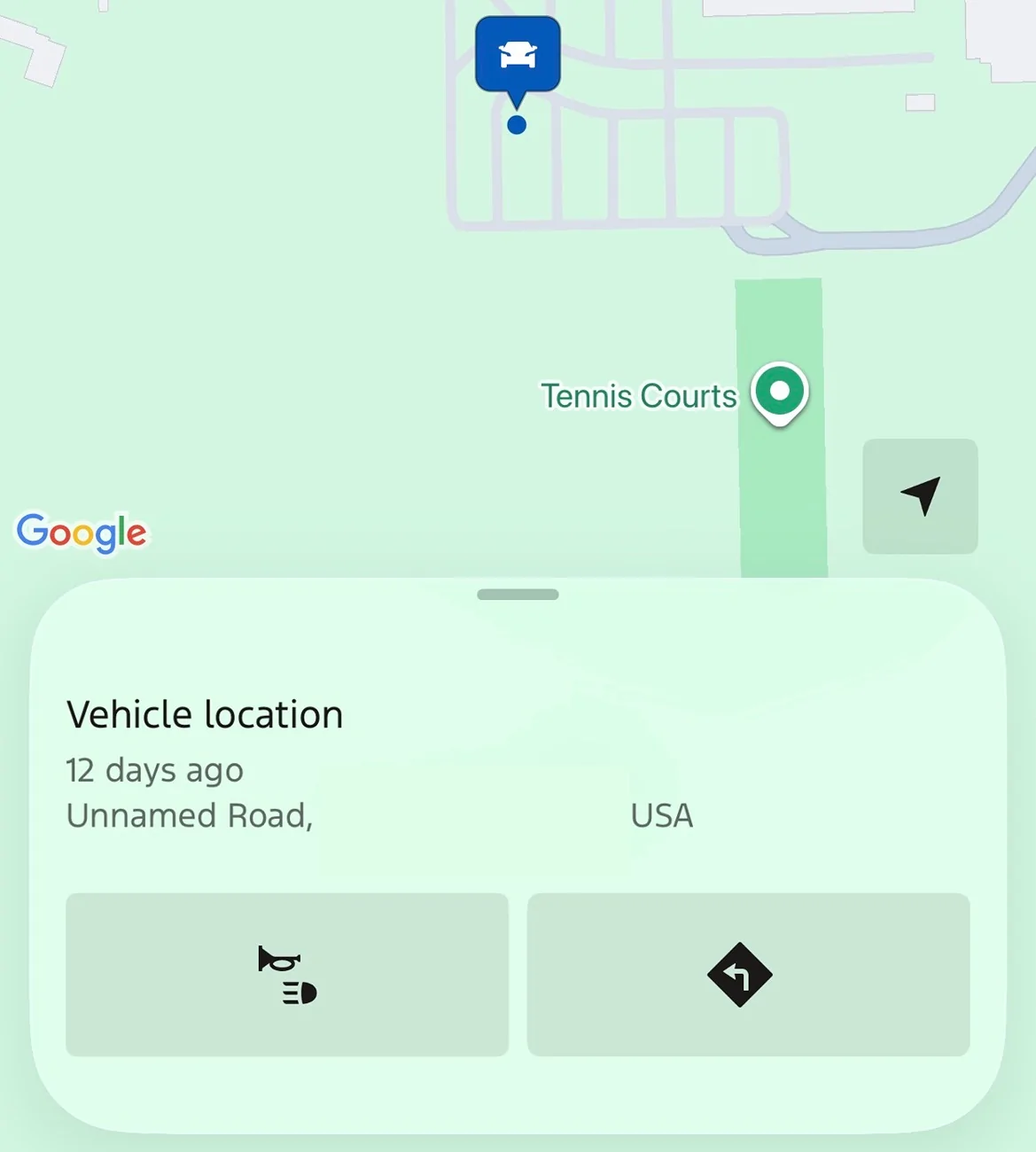

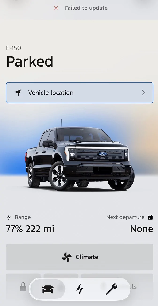

yeah guessing they're still having issues. My location hasn't updated since yesterday and manual refreshes are failing as you mentioned.
I guess it’s been more than a week… (see images).
Would a uninstall app / reinstall do anything or is the SYNC system on the truck itself faulting?
