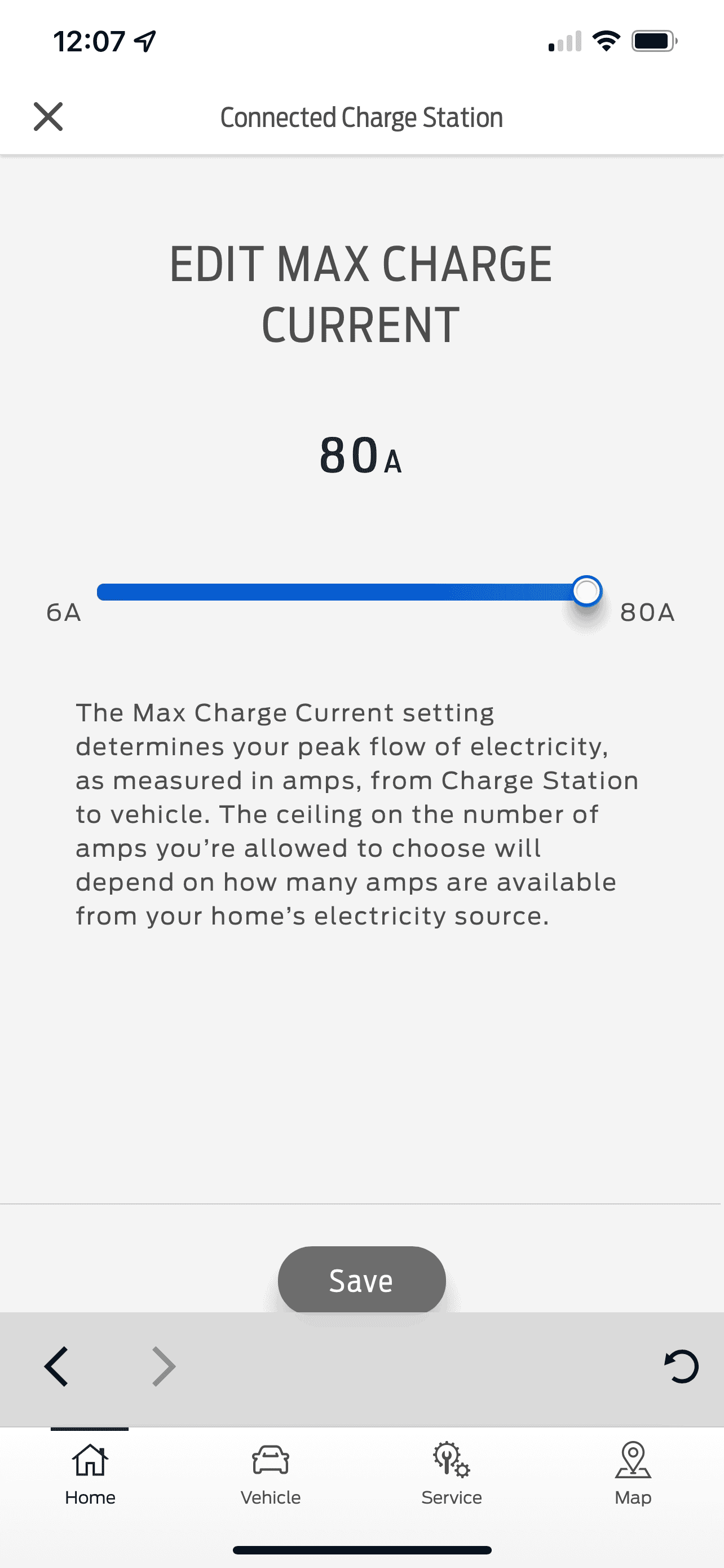

I'd be curious to see if you dial the Pro Charger down to 32 amps "Switch Position 3", if it changes the selection available in the Ford Pass App to max 32 amps. Not curious enough to open mine and try it myself, but curious enough nonetheless if someone else does it. I've learned the hard way from past experiences to leave well enough alone unless absolutely necessary...:oops:

Yes, the hardware setting cannot be exceeded by software. That makes it code-compliant to install on a lower amperage circuit.
Generally, the switch should be set to match the branch circuit ampacity (32A for a 40A circuit, for example).

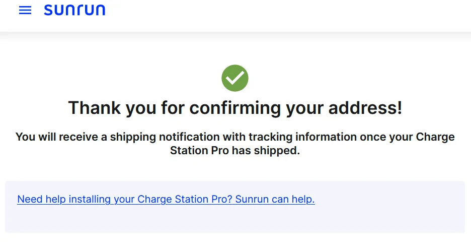

However, I continued to get the "Please confirm your shipping address" emails since that time. Like almost everyday. I was ignoring them until this morning and decided to click the link (again) just to see....
So I put in my order number, zip code and last name and this time things were different. It actually took me to a page that showed my street address and asked me to confirm that it was correct. I clicked the "Verify" button and then got this:
Ford F-150 Lightning Ford Charge Station Pro Unboxing and Install Guide Sunrun_confirm
NOW I think I may be getting somewhere.
So if you've never been contacted by Sunrun and you've taken delivery of your Lightning ER already, and your order for the truck was submitted by your dealer and not by you on the Ford portal, you may need to contact Sunrun because they probably don't have your street address to ship your charger to.
