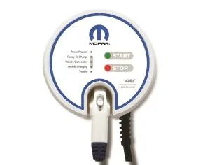

I think "fine" for one person may not be "fine" for another, especially when you are talking about time to charge. I will tell you based on experience that it takes quite a bit of time to take the truck back up to full with a 32amp charge when it is down under 50 miles. I have posted this elsewhere on this forum but I will share it again. I have a home in Maine where I have a Level 2 EVSE made by AeroVironment installed that was given to me by Chrysler when I purchased my 2017 Pacifica Hybrid. They were 6 months late and Chrysler gave us these chargers as an "oops sorry your van was so late". It charges the 16kw battery pack in the van up in 2 hours. When I got to my home in Maine it was around 10:30pm and I plugged my truck in. The truck was fully charged at around 4pm the next day. So if I was doing a quick trip to my home for an overnight and then I wanted to head out to Acadia or elsewhere in the morning with a full truck, that wasn't happening overnight with the mobile 240 charger. That's where the 80amp charger comes in. It will have the truck back up to whatever charge level you want in a much more reasonable time than what 32amp charging can give to you. I will give you another example with my Mach E. I drove it home from Maine back to my house NY. I had 70 miles left to spare when I put it in my detached garage. I didn't have an EVSE hooked up in that garage yet so I plugged it in with the 115v mobile charger. This was around 12pm on a Saturday. My Ford pass app told me I would be fully charged at around 2pm on Tuesday at that charging rate. So yes, because I have my van and wasn't planning on using the Mach E it was "fine" with me for it to take that long, but for others it may not have been. So yes the truck does come with both a 115 and 240 charging solution, and as long as you aren't in a rush to have a fully charged vehicle from close to empty then, yes, they are "fine". If you work with your truck or have a long roundtrip commute and go low on the battery and want and expect a fully charged truck overnight then those solutions aren't going to be fine. That's what the 80amp Pro Charger is for. Just thought I'd share my experiences. I have attached a photo of the EVSE I have in Maine.
