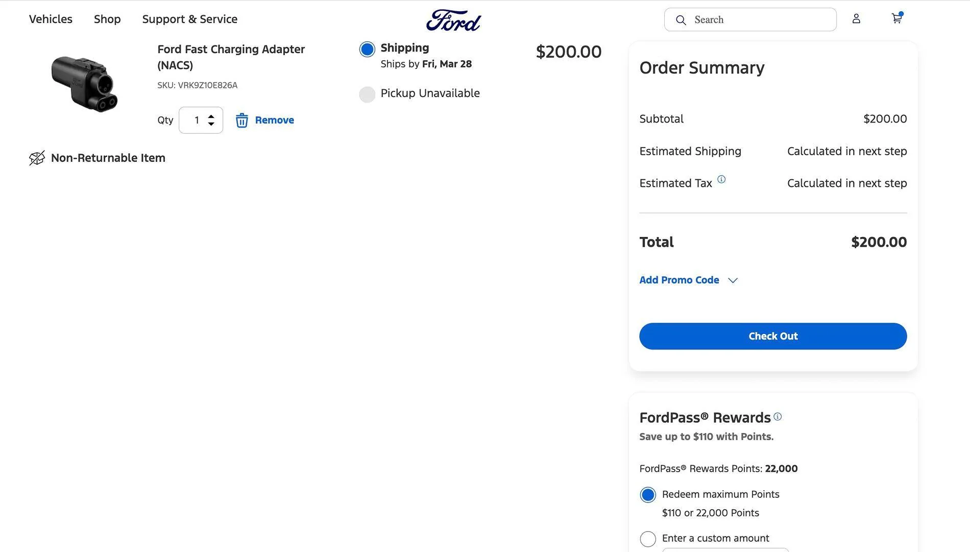

When I bought my truck (2024 Flash) the Ford adapter, which I believe is a version of the Lectron, wasn't available. I got an A2Z adapter from Canada and (with some quirks) works fine at Tesla Superchargers.
I just received an email from Ford that their adapter is available for $200. I can use my my Ford Points (what else are they for BTW?) to knock off half. Is there ANY reason to buy another one at this time? I don't think either is UL listed as there is no official UL test for that particular product yet. A2Z seems to be the closest (as opposed to some of the Amazon Chinesium stuff I don't trust).

I know Ford has gone into all the testing they did with their version of the adapter which you can find other posts on. If that appeals to you it might sway things. Also be sure to use the coupon codes (usually listed on the main Ford Accessories page) before paying with FP points as I was able to get mine for $160 before paying the rest with Ford Pass.
That said, you know the quirks of the A2Z and already own it. As long as the quirks aren't deal breakers I don't know if I would spend the extra money unless I was using the adapter every other month at least. We so far have only needed the adapter maybe a couple times per year. As long as there wasn't a safety concern with what I had I wouldn't bother buying another one.
