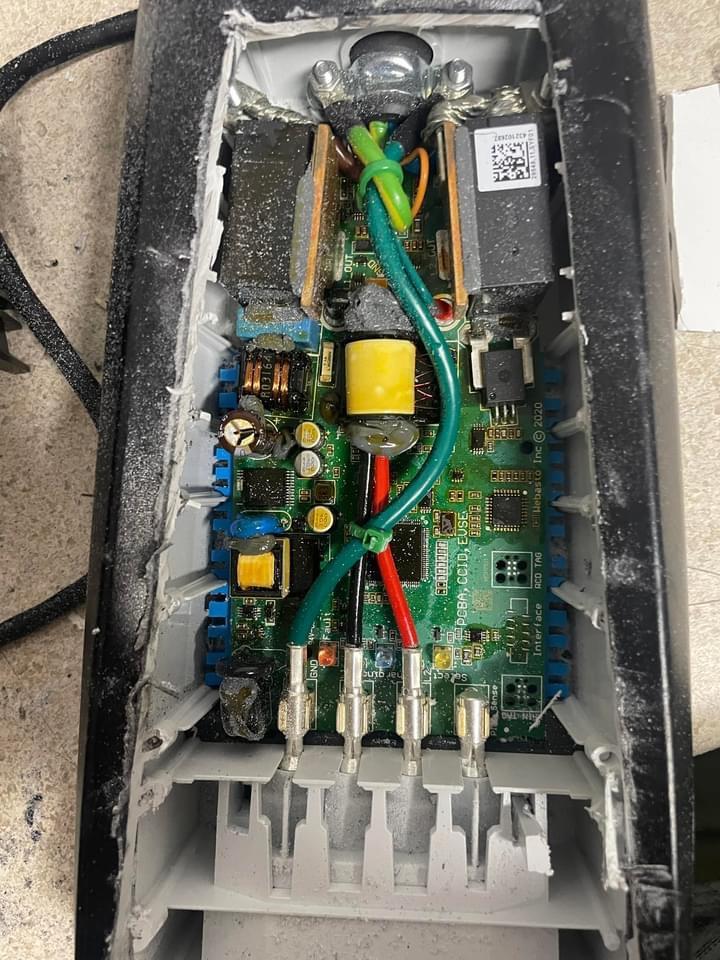

Someone on the MachE Facebook page posted some photos of the inside of the mobile charger. Their charger failed so they cut it open to see if they could identify the problem. Apparently the unit is sealed and cannot be opened without destroying the case.

Interesting to see. Thanks for sharing.
Mine overheats and de-rate itself to a lower current and keeps fluctuating. I just stopped using it. If someone told they had the same problem and problem was a component like this, I would open up and try to fix it.
Ford F-150 Lightning Ford Mobile Charger Internal View 1721151767654-dh
But if it is one of those chips, I wouldn't bother.
I would try a new 240v dongle before opening it up.
Never thought of that. I did lose the neutral to my house a while back which screwed up a few pieces of electronics. I suspect, that may have messed up one of the components in there but you suggestion makes sense. I will check it when I see my cousin that has a mustang. Thanks.
Interesting. Been several postings of failures of these over time by people using them daily, one where there was a nearby lightning strike that may have cause a surge current/voltage to the unit.
Doesn't use the neutral, just 2 hot and ground, I traced the wiring myself through the dongle.
The neutral pin is N/C.
But if the outlet was wired wrong, and the neutral was lifted (not connected to ground at the main service panel, then maybe...
Three pin circuit board devices are usually transistors (triode).
We know this is a Webasto Go EVSE from the circuit board marking and other information.
Looking it up, I could not as yet locate a circuit diagram, but the item is available on Amazon:
https://www.amazon.com/Webasto-Dual-Voltage-Portable-Charger/dp/B0BTK7WPLZ
32% gave it 1 star on Amazon!
Lots of failures!

Mine got water in it while charging one day after it had rained. It started malfunctioning and giving me a red light error all the time. I took the adapter out - filled with alcohol, let it drain and dry in a warm dry area. It has worked great ever since. Just posting this in case other people have the same problem if charger got wet inside.

Was there any failure analysis to go along with that FB post? Like does he know why it failed at all?
