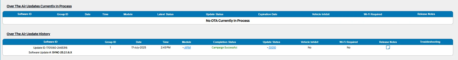

They can 100% see what modules have pending updates.
There was nothing wrong with your car. It was talking to the cloud just fine. They just haven't sent you any updates since July. 4-5 months without an iupdate is not abnormal with the way this works. If they did send you updates between July and now, they would appear in your OTA dashboard below whether they installed or not.
I don't know. thats what she said. maybe she didn't know how. whatever she was looking at said my car was in a disconnected state. doing her stepped procedure, put it back in a connected state. Unsure if the disconnect was associated with changing over to a new account and needing to set the update schedule under a new profile.
the way she described it is she did see the july update but as long as the car is in a disconnected state, the OTA system doesn't even try to push updates to a "disconnected" car. once it is in a connected state, the system will try and push the next go around.
It would be interesting understand how they organize all the builds and how campaigns are pushed, timed out and then it returns to push again.
I know you have extensive exp with this but it only took a few minutes and on her end she said she immediately said it looked disconnected and then afterwards was able to see it show as connected.
I know it was connected and talking to the cloud because your DTC history is there for 60 days (which is as long as it is kept on the cloud). If your truck was not talking to the cloud, the connected data would only show a few days of history based on whenever you did whatever they asked you to do.
Even if auto updates was set to off, you would get a notification that an OTA was pending and needed your permission to install.
