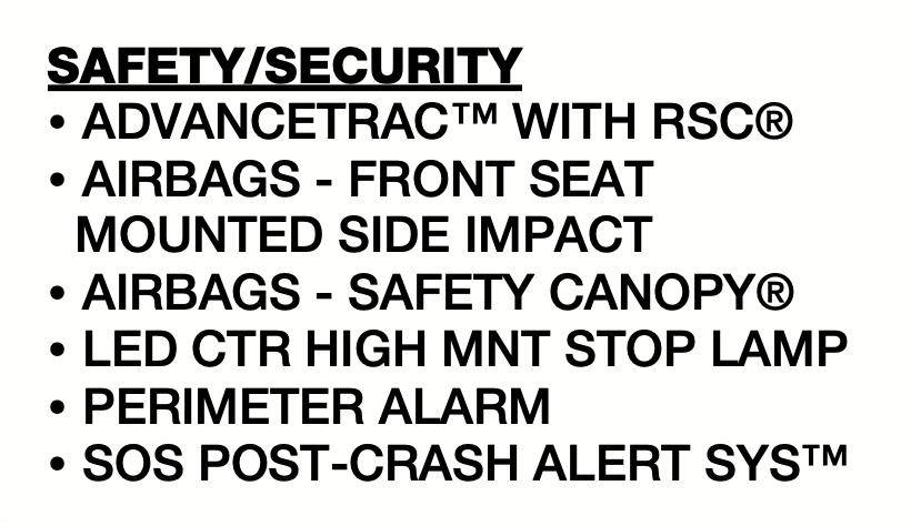

Do you recall whether your truck was sold to you with the window sticker noting that the security system had been “removed?” The upper part of the sticker on my truck (‘23 Lariat) listed the security system among the many features of the truck, but in the sticker section that tallied up the cost of the truck’s features there was a $50 deduction shown for removal of the system.
My window sticker lists a "perimeter alarm" in the Safety/Security section. I have no deletions or credits listed under the Cost breakdown.
2023 XLT ER Option / Package 312A, built in Nov 2023.
