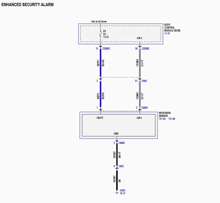

Another way to indirectly confirm the DIY female pin placement and assignment is for anyone here who does have the OEM wiring connection already present, to share a pic of what the female pin connector looks like, with the three present female pins visible (to establish which of the sensor's four male pins is unused).
Here’s a link to the connector on an ICE truck. This matches the way I wired mine. Again, can’t confirm it is correct though.
21st Century Truck
Martin
Jul 11, 2024
1,177
1,476
Thanks. So from the F150 Gen14 post it looks like the leftmost male pin in my sensor picture (post #74 above) is the unused male pin.
I can guess the 12 Volt pin from that post as well... I think (the blue PosiTap to the rear window circuit).
I'll look again, harder to identify the ground pin and once that is clear, that will naturally resolve the LINBus pin identity as well.
What you state sounds right to me as far as pins and wiring. In that post the user says the T-taps are for dashcam power and ground (you would need the ground only). Going right to left I see Power, LIN, Gnd. There are numbers on the connector that correspond to this order but they are very small.
Oh wow I looked for the numbers but missed them. Thanks!

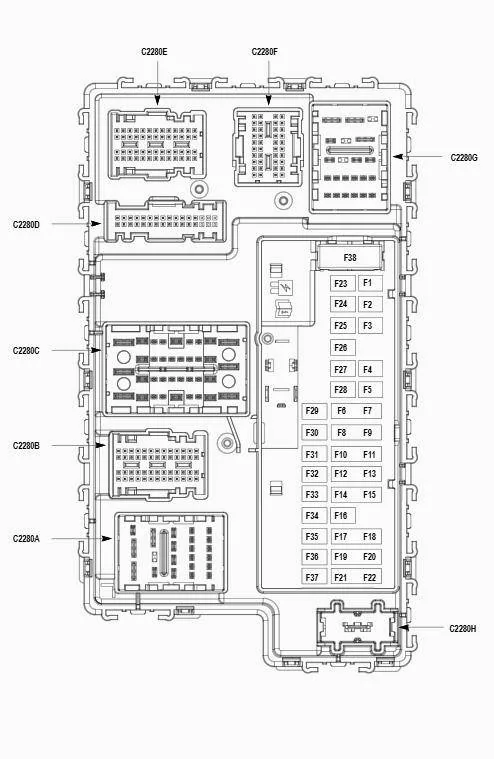

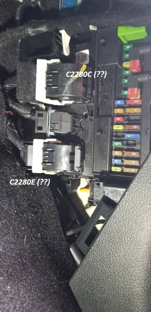

So I added the blue sensor box and cut out the aperture slits on my 2023 XLT. Now I'm running the wiring down to the BCM.
Can anyone here confirm that the two BCM connector plugs with the white locking levers in my attached picture are indeed Connectors C2280C (middle connector) and C2280E (bottom connector)?
...or otherwise pls do
Ford F-150 Lightning Ford Perimeter Plus Security System Lightning BCM
steer me straight in my Lightning BCM geography.
