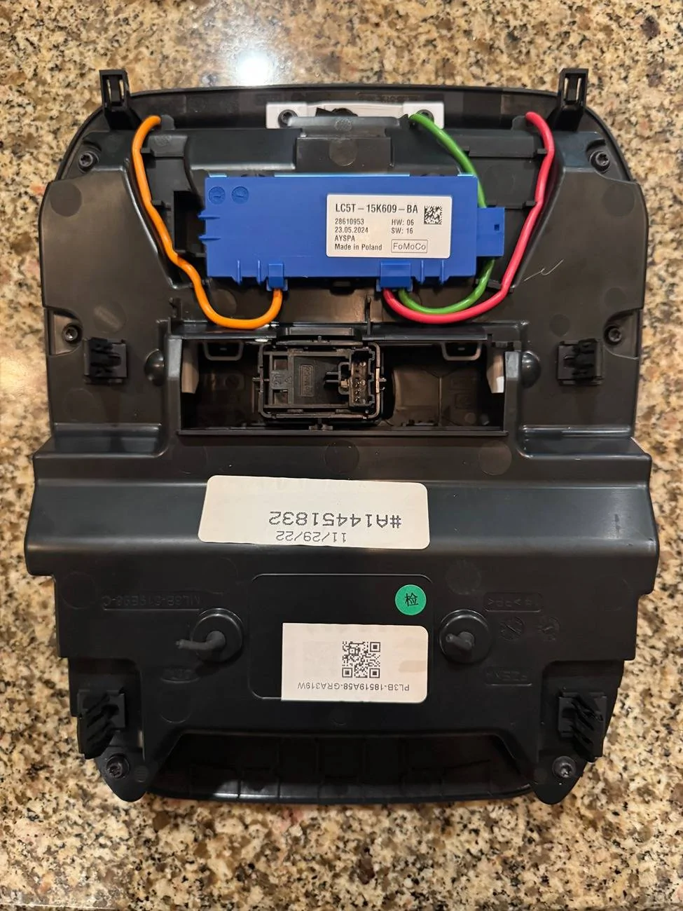

Based on the pictures of the replacement part they installed, I see other folks have had the same thing happen. My replacement part came in packaging labeled LC5Z15K609A and "Made in Germany." However, the product itself has LC5T15K609BA on it, and it says "Made in Poland." ChatGPT says this is relatively typical of Ford Motor Company. In @mrau's excellent write-up, he has the same packaging/part label discrepancy; only his infrared sensor is labeled "Made in Germany." I haven't ordered that many Ford service parts in my life (like #2), so there's hope in time that I'll get used to this nonsense (as long as the part ordered works and lasts a long time!).
Jim Lewis
Jim Lewis
Jan 10, 2023
56
1,082
1,064
San Antonio, TX
Lakeland Ford Parts gave me the following explanation of Ford's part number policy and a link to Ford's own explication...
The number stamped/embossed/stickered on the product (LC5T15K609BA) will never match the number on the outside of the box. The number on the box is the service part number while the number physically on the part is the engineering number, these numbers will never match.
Engineering numbers are used during production of the product prior to being packaged for sale, hence the reason you only see it on the part. Once the product is packaged for sale it is assigned a service number (in this case it is LC5Z15K609A) which is used by dealers to maintain their inventory and sell product to customers.
We hope this explanation offers some clarification, if you would like additional confirmation this is a good site to look at: https://www.fordification.com/tech/partnumbers_overview.htm
I suggested that they include at least a link to the Ford page on the packing slip they include with the part shipped. It would help Ford part ordering newbies like me understand the Alice in Wonderland nature of Ford part numbers and "Made in xxxx" on the packaging that doesn't match the "Made in yyyy" on the part.

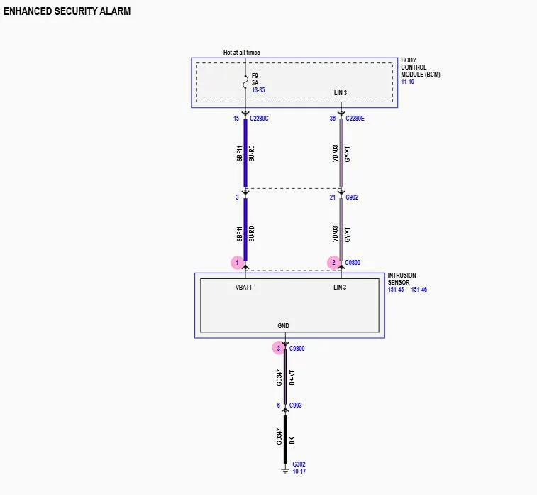

Having a Pro, I'm in a similar situation as you where I'd need to open up the slits for the sensors to work. If it helps, I believe that these are the parts you'd need for a DIY harness running to the BCM (but I have not verified yet):
Sensor Connector: TE 1241634-1
Sensor Connector Pins: TE 5-928999-1
You can pick up ground from the overhead console harness (pin 6).
Edit: Also, I believe that these are the two pins you'd need to use for connecting to both BCM modules (but, again, I have not yet verified)
Power - C2280C Pin 15 (Fuse # 11)
LIN Bus - C2280E Pin 36 (LINbus # BCM # 3)
So the sensor (the missing sensor that we are all emplacing or trying to emplace in the overhead bin) has four (4) wire male pins in its connector.
The DIY wiring harness here and in Jesse Infotainment's diagram has three DIY wires.
So when DIY-emplacing the new wires, which wire goes to which of the four sensor pins, and which sensor pin should remain as the unconnected orphan? Thanks in advance! ...maybe I had missed something in one of the previous posts.
So, I haven't done this mod yet and I don't have the sensor, but I have made the harness so I can add it in the future. I wired the connector based on the attached diagram provided previously by Jesse. If I read it correctly, it looks like we need pins 1-3 (highlighted in pink) and the fourth is not used:
Pin 1: VBATT
Pin 2: LIN 3
Pin 3: Gnd
Ford F-150 Lightning Ford Perimeter Plus Security System diagram
Pin 1: VBATT
Pin 2: LIN 3
Pin 3: Gnd
Gotcha... I remember that diagram. I'm ginning up my DIY wiring now, hence my question.
Of note, this is what the sensor's four male pins look like... hence my pin order question. Pls see attached pic.
Ford F-150 Lightning Ford Perimeter Plus Security System Perimeter sensor - 4 pins
