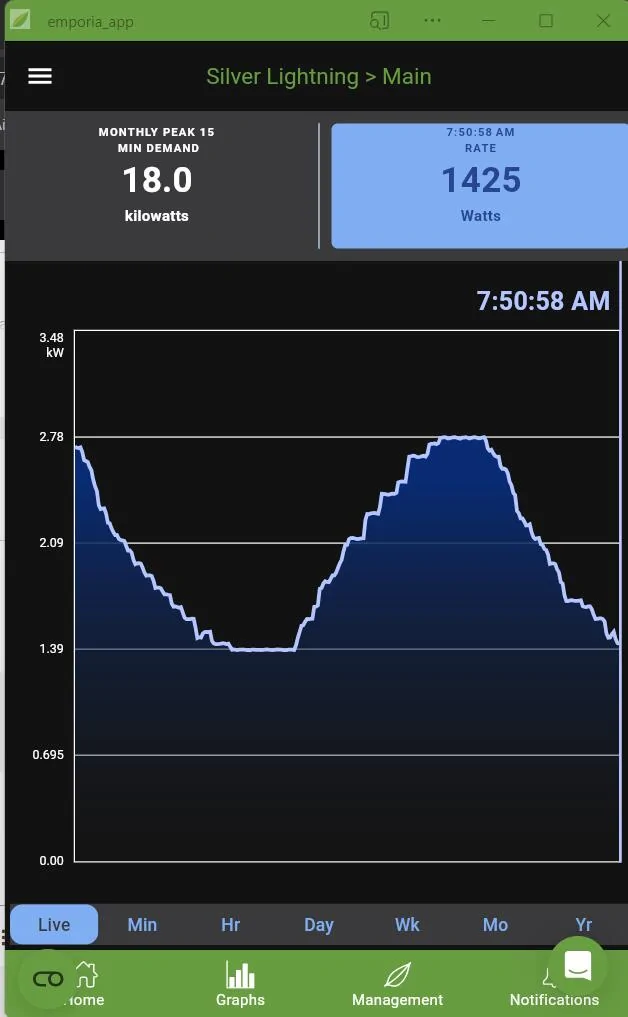

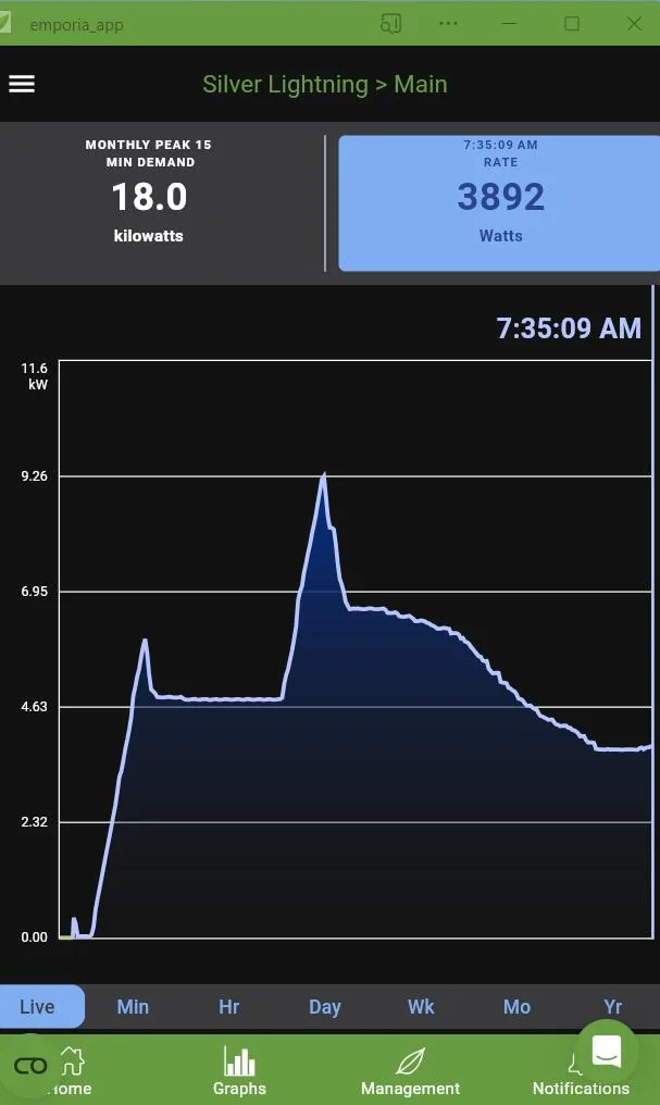

Follow up to how the departure time / pre-conditioning energy draw looks via an Emporia Vue2 energy monitor. though I have a FCSP set with the capability to provide 80 amps of energy, my truck with an SOC [92%] above the charging set point of [90%] is only pulling the following levels averaging 4 to 5 kW at the moment, this will continue to tapper off.
The outside & garage temp is about 40 degrees, I set a departure time of 7:50 am, we will actually leave just after 8:00 am. The Truck decided based on conditions to prepare the truck & cabin beginning at 7:30 am, this will continue until 8am
Ford F-150 Lightning Ford Pro Charge Rates… Really. 1729856410717-nm
Live shot at 7:50 am, energy continues to flow until 8:00 am, notice the modest amount needed to maintain temps, the Ford Pass Alert just came in to let me know the cabin is ready to go.

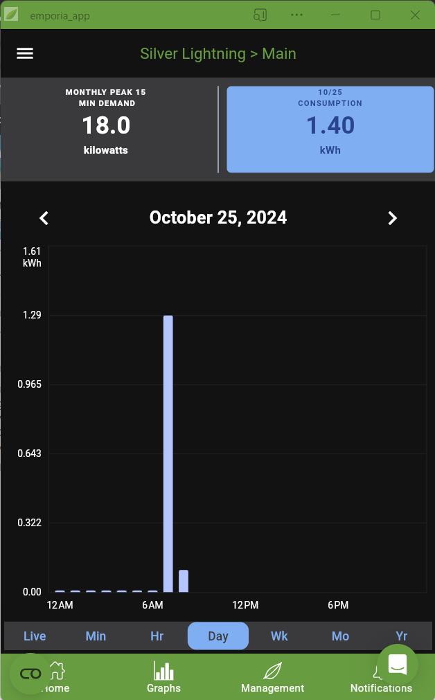

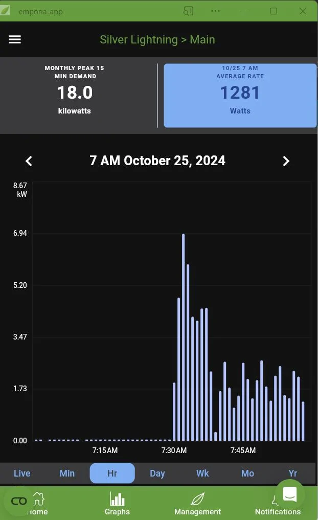

30 minutes view & Total Energy used charts.
