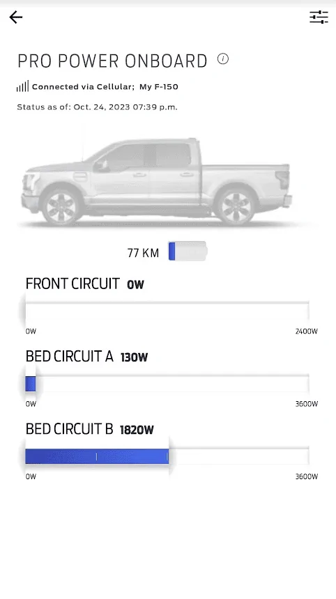

Seems fordpass is always slow and appears to be talking over cellular instead of wifi even though the truck is connected to my home wifi network.
The same wifi network my phone is paired with.
I lost power today and was watching the propower screen and it says its on cellular.
Ford F-150 Lightning Fordpass always connecting via cellular and not wifi 1698202587154
Does any one have experience with this problem?

Thanks. I understand the telemetrics goes up to cloud servers. But shouldn't that be happening over wifi when a working wifi network is available? Or does the truck not do that?
It would be nice if...
  • Telemetrics went over wifi when wifi was available. That should speed things up a little.
  • Fordpass could negotiate a local direct wifi connection to the truck when the truck is powered on, connected to wifi, and your fordpass device is on the same network.
The propower screen is great to see if my 2 120v split phase legs are balanced when I'm powering appliances around my house. But its pretty useless in its current state with how abysmal the update time is.
