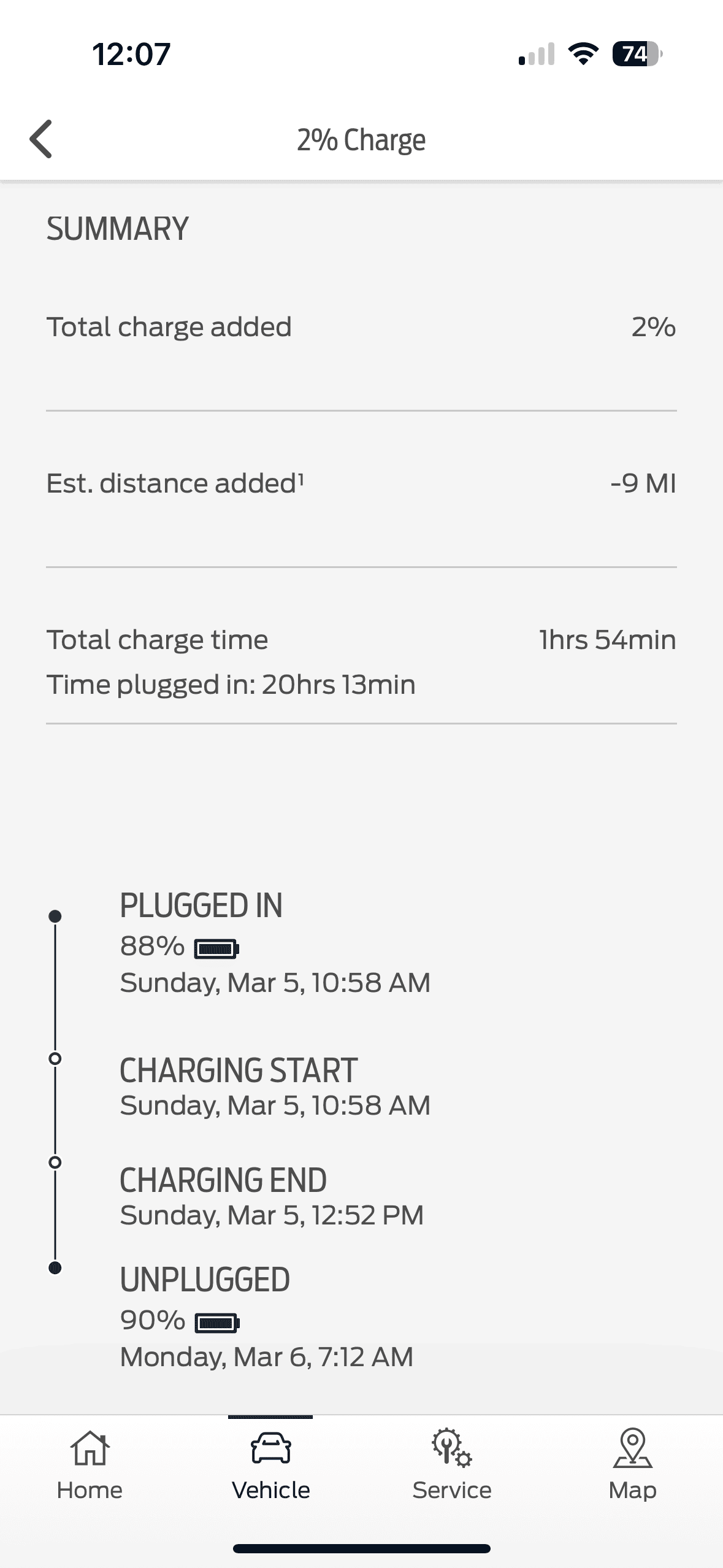

My FordPass app is no longer monitoring my charging status, updating ev driving log, or charge logs. This seems to align to my connected services/ Ford streaming trial ending. I didn’t see anything that said these features required Ford Connected Services.
Anyone seeing this issue or can help explain to new user?

May be for the best. Charging reduces miles? App needs some work.
Ford F-150 Lightning FordPass App Not Connecting 75031381-6700-4C1A-897A-A771F821740D

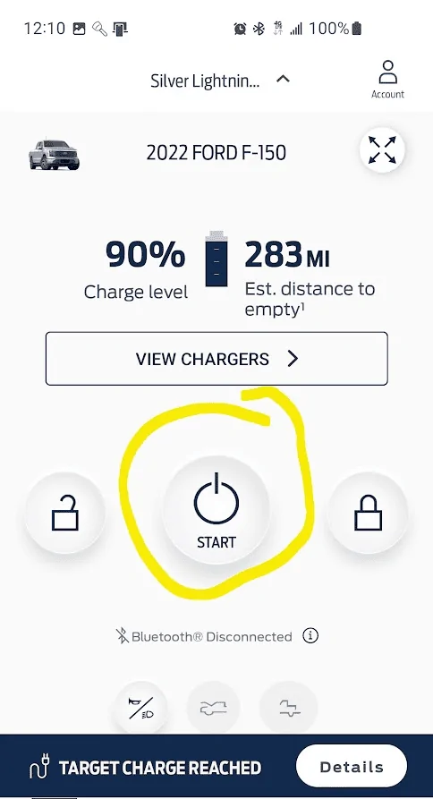

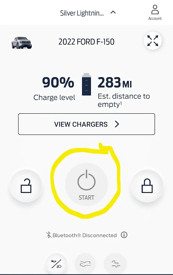

One thing I would like to point out for both model year 2022 & 2023 owners, Ford Pass occasionally grays-out the START control button on the home screen. It happens infrequently, but it's easy to resolve.
Here is a snapshot of the button before the fix
Ford F-150 Lightning FordPass App Not Connecting 1678637875577

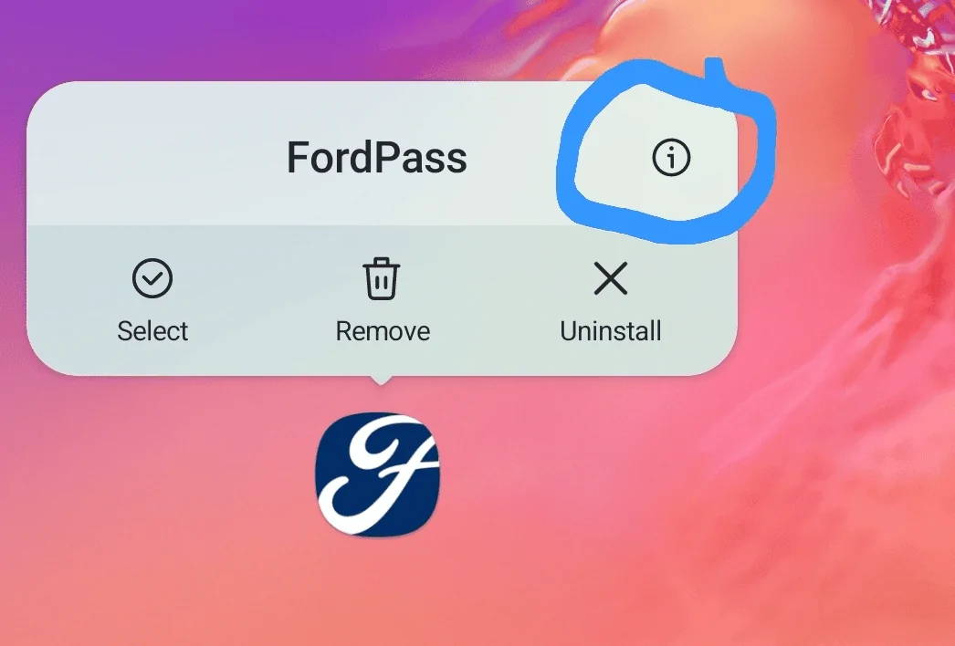

To remedy this condition, go into the device app controls, on ANDROID, you select/hold your finger on the desktop icon until a context box appears, then select the i in a circle icon for [information] .
Ford F-150 Lightning FordPass App Not Connecting 1678638054985

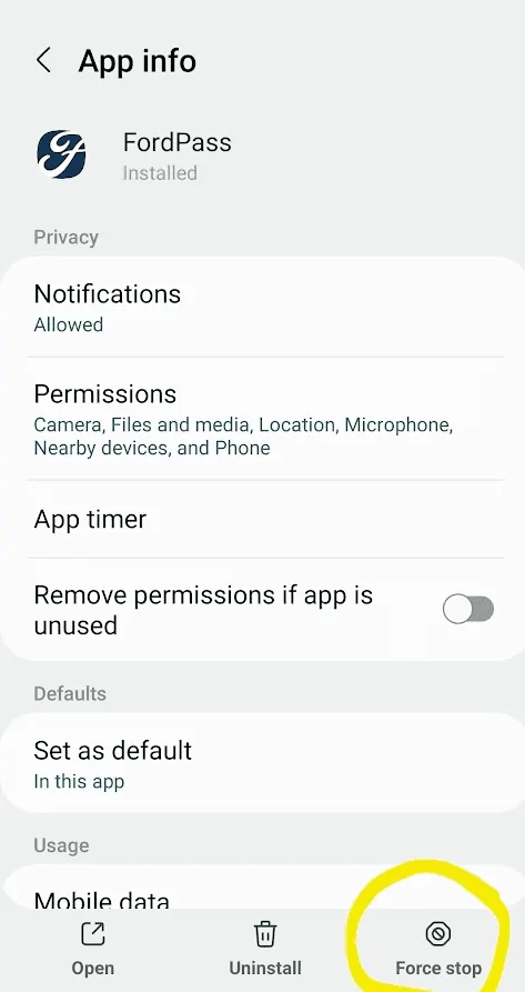

See the FORCE STOP button, hit it and confirm the action.
Ford F-150 Lightning FordPass App Not Connecting 1678638131110

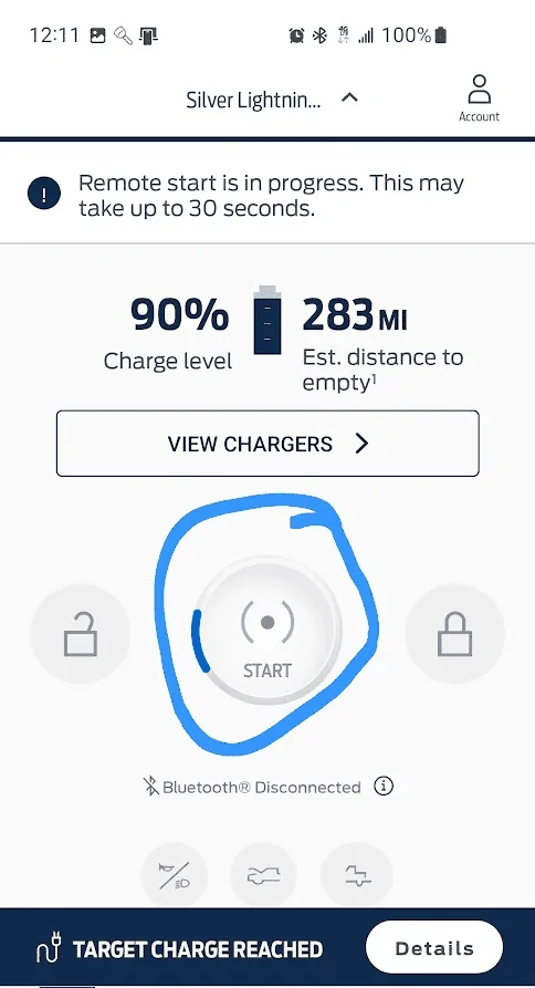

Now launch the app again, you will see the START button is no longer gray.
Ford F-150 Lightning FordPass App Not Connecting 1678638271461
START now works.
Ford F-150 Lightning FordPass App Not Connecting 1678638294946
