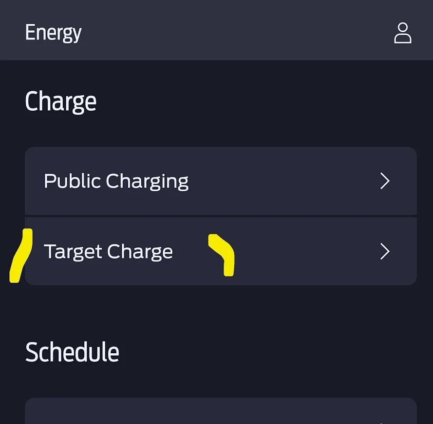

Have you tried editing the "Target Charge" value under energy?
ie. change the value from your default 85% to a higher value say .... 90% or 95%, remember to click the "Save" button and wait for it to post, might take 30-60 seconds, it should start charging to the revised value assuming you are already plugged in.
Thanks Taxman. I’m going to try the target charge adjustment and report back.
Deleting and re-entering the schedule is the least ideal work around. Adjusting Target Charge will be easier, if I can get it to work.

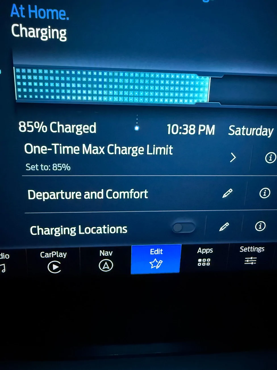

The target charge adjustment did not work for me. The truck would not start the charge off schedule even after adjusting the target charge.
But, I did find a workaround that is better than setting an alarm clock or reprogramming the schedule.
1. I plug in my truck off schedule.
2. In the truck, I set One-time Max Charge Limit to the limit I want to charge to. 85%
3. I toggle the Charging Locations button off.
4. The truck starts charging to the One-time Max Charge Limit.
5. Tie a ribbon to my finger so that after unplugging so I remember to toggle Charging Locations button back on. Schedule is saved and I don’t have to reprogram the schedule.
