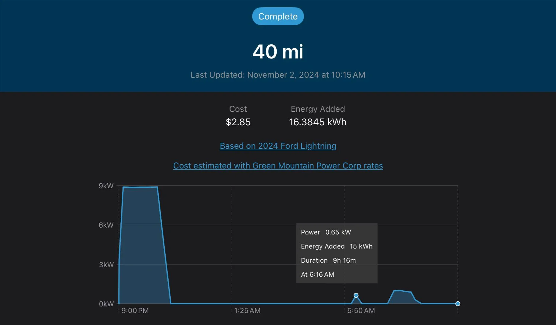

I have a 24 flash that is fully up to date withe FDRS and the latest iOS fordpass app. Within the last month or so I have noticed a weird preconditioning bug that causes the truck to randomly start the conditioning 2 hours before the set time, then it sends an early notification that’s it’s done in app, waits 2 hours and finally preconditions at the set time with no notification in app.
But it does not do this every day or on a predictable schedule. See attached photo

How cold was it around 5:50 am?
Assuming that is the point of concern, it doesn't look to be very long of an episode, but it may have been the EVSE cycling to touch up the SOC from the earlier 9PM bulk charging event.
As we get into the cold season, you should see the departure time trigger a vehicle preparation phase upwards of 30 to 60 minutes prior to departure time, this is when the battery is being warmed up, later in the process the cabin warming phase should kick in five minutes prior to programmed departure time and will continue to run 5-10 minutes afterward (depending on the default duration of your remote start preferences 5, 10, 15 minutes)
I'd say all looks normal.

It was in a heated/insulated garage which is usually 65 degrees, so I don’t think this was it. Also because the notification In the app is popping up early 6:15am in this case 2 hr before 8:15 set departure.
it’s also weird that it doesn’t get another notification at the correct time it ends even though it does it correctly.
that’s why I thought it was time zone related after the last reset.
I am also comparing this to the behavior of mache in the year of ownership, it never triggered the app early with a notification while it was keeping the battery warm when we got below negative temps.
