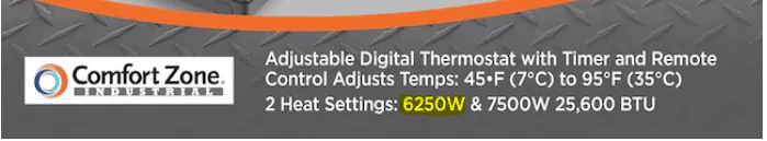

It's a 7500 Watt heater, with a 6250 Watt low setting. It should work on the low setting only and probably will trip the truck's breaker on the 7500 Watt setting. As long as the heater does not default to the high setting every time you restart it, it should work. You'll be reducing your truck's range about ~15 mph of heater use.
Also, this is one of those things best used with short, heavy-duty extension cords (30 Amp Low setting), or none at all.

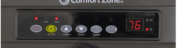

Does not have electricity in the garage. I would like to to use his power with extension cords from his house for some heat. I use it for a couple hours
thinking something like this just not sure the truck can power it
https://www.lowes.com/pd/Comfort-Zone-Digital-Fan-Forced-Ceiling-Mount-Heater/5000235905

7500 watts, /240v = ~31 amps, you would be exceeding the capacity of the 240 volt bed inverter, but the heaters MODE BUTTON has a low/full power setting.
Ford F-150 Lightning Garage heater 1651507072337
There you have it, 6250W mode would do the trick!!!
6250w / 240v = 26amps
Ford F-150 Lightning Garage heater 1651507139622
