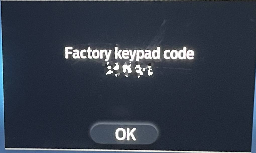

This procedure did not work for my 2022 Lariat SR. When I removed my Phone As Key (PAK), the door combination was reverted back to the default factory code which I didn't have. I went to Ford and they used an electronic device that plugged in under the dash. And with some software on his phone, he was able to provide me the default factory code. Took about five minutes.
I just tried it on my 2022 Lariat ER. It worked for me. It showed the 5-digit Factory Code, not my programmed door code. However, the code was different than the Securicode that was printed on a wallet card I found in my Owner packet.
EDIT: While the SecuriCode and Factory code were "different", they were the same key presses. For example the digit may have been "1" or "2" but they are the same key since each key has two numbers on them, i.e., the code "13579" is the same key press sequence as code "24680".
All codes unlocked my door - personal code, SecuriCode, and Factory code.
Ford F-150 Lightning Good video of finding your factory door code! Factory keypad cod
This message was cycling though the dash display along with "Full Accessory power active" and "Key battery low Replace soon".

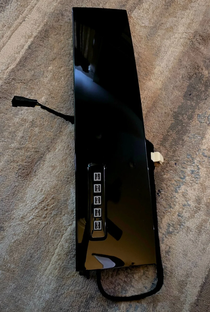

When I had mine connected to either Forscan or FDRS, don't remember which, it showed the keypad option turned off so I turned it back on as I'm going to install the factory hard wired keypad. Have the parts already, just waiting for the weather to cooperate.
I noticed the wiring for the keypad is still inside the door waiting for a keypad to be plugged into it. Then I'm almost certain the key code can be obtained via the 2 key method.
Pic inside door showing keypad harness capped and attached to the door brace.
