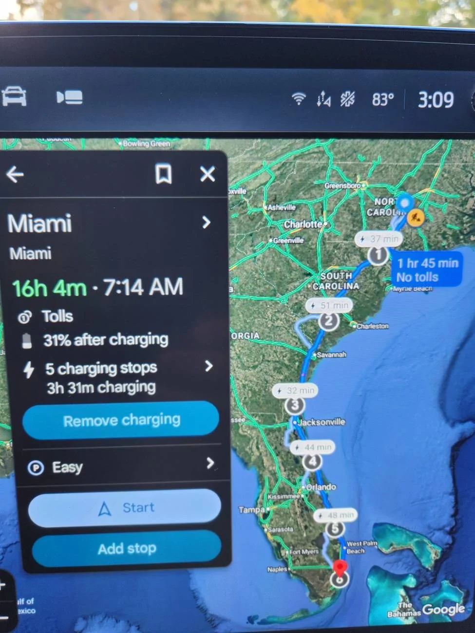

Looks like the 1 in the circle may be related to tolls. Just noticed that's the same icon that's in my screenshot with a Tolls note beside it.
Ford F-150 Lightning Android Auto getting EV battery information integrated into Google Maps (starting w/ Lightning) 20241030_151025
240
16,974
19,326
I suspect you're correct, the route I simulated in my post did include a Toll on Route 101 running from Hampton toward Epping NH.

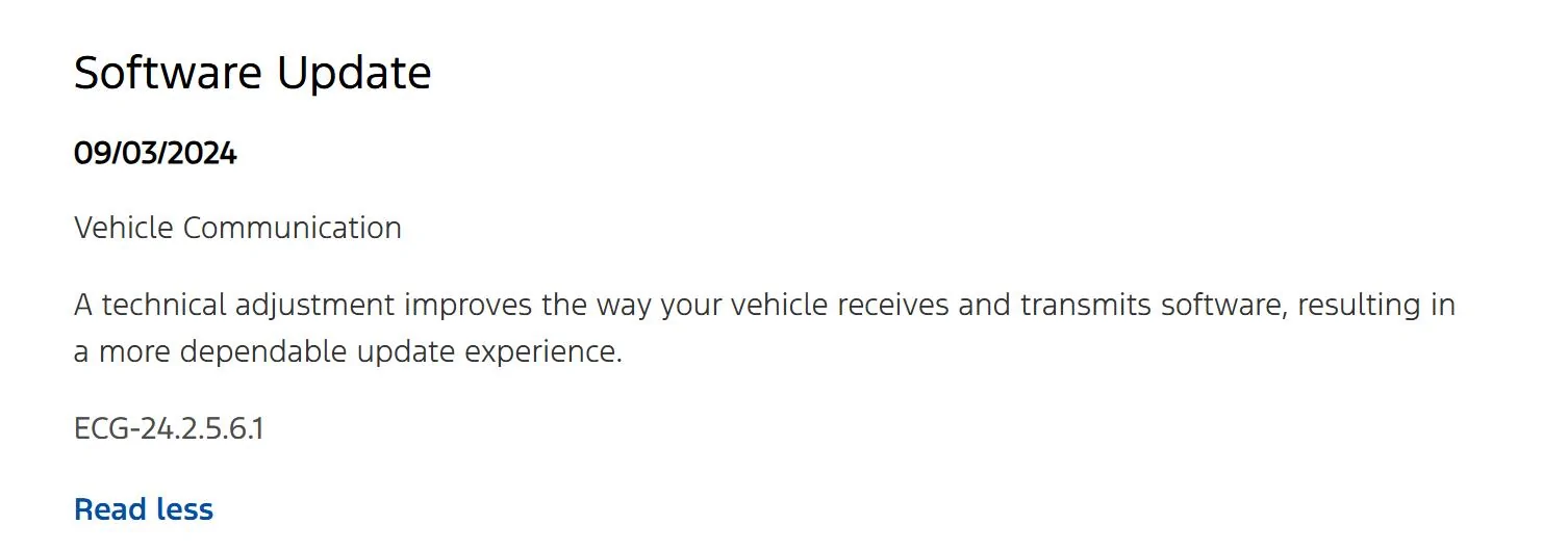

yup. Have the cable and power supply. Spent about 6 hours installing all the updates on mine a month ago. What software version do you see at the top of Software Release Notes?
Ford F-150 Lightning Android Auto getting EV battery information integrated into Google Maps (starting w/ Lightning) 1731185310834-2
I just want walk away lock and Android Auto routing. How long do those modules take to do? We can take this to a PM if you want

So I tested the Android auto Google maps with the update. Good news is it works for regular driving with EV charging routing no problem.
Downside is it does not recognize tow mode. Hence the Google maps still thinks your efficiency is the same as driving without the trailer. If you used this while towing you would run out of electrons.
You can still use maps but forget about relying on it for trip planning while towing for EV charging as it doesn't adjust down your efficiency when you connect the trailer. I'm an experienced EV owner so it doesn't impact me but still something to be weary of. Hope Ford and Google can figure this out. Seems simple enough.
