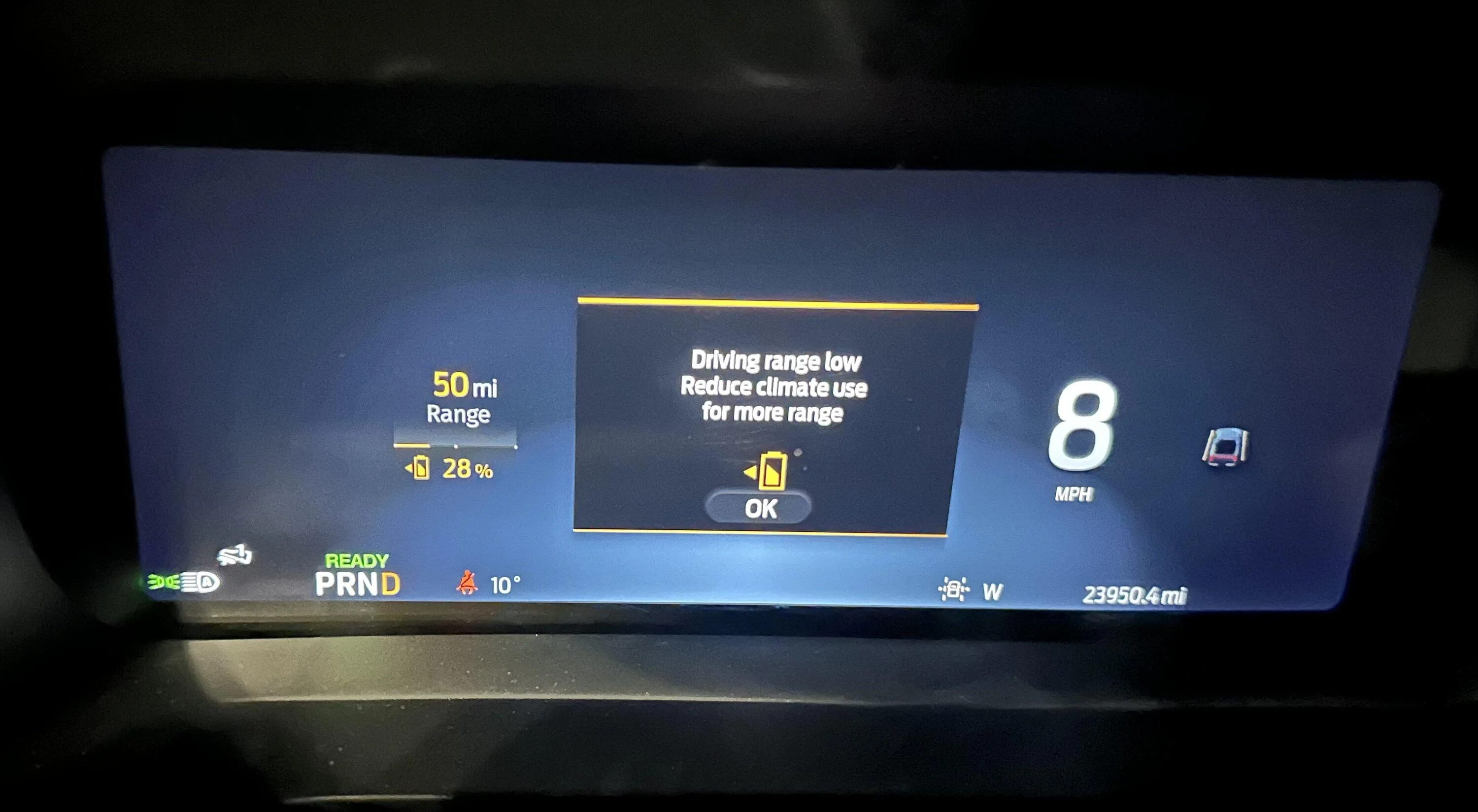

I have traced mile by mile. 111 exact miles total today. I did video my dash from my last stop to home expecting it to reset to the correct miles. But didn’t think to take a picture before it changed because it seemed normal. I’ve tracked my miles pretty religiously to and from work and I know this truck. This has to be a glitch. Should I check forscan to see if I can see what the HVB reads?

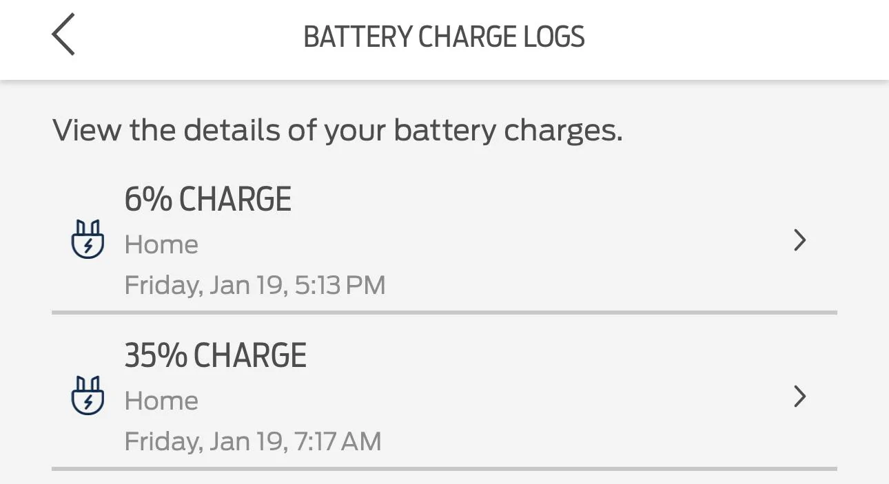

Here is a screen shot of my charge log. I charged as soon as I home home today and it reached my 90% set point.

How much kW was used during charging as recorded by your charger?

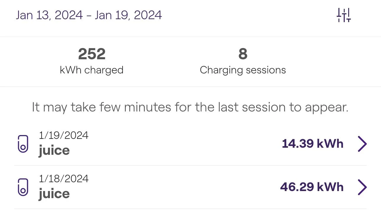

Looks like 14.39 kWh when I got home.
Why did it stop at 14.39 KWH when your battery was so depleted, do you have any time of use or SOC limit rules in the Juicebox or on the Truck?
Ahhh, I see in the prior post you charged multiple times this day and you have a limit of 90%.
I can't explain the odd screens you seen previously but definitely shoot photos if it recurs.
