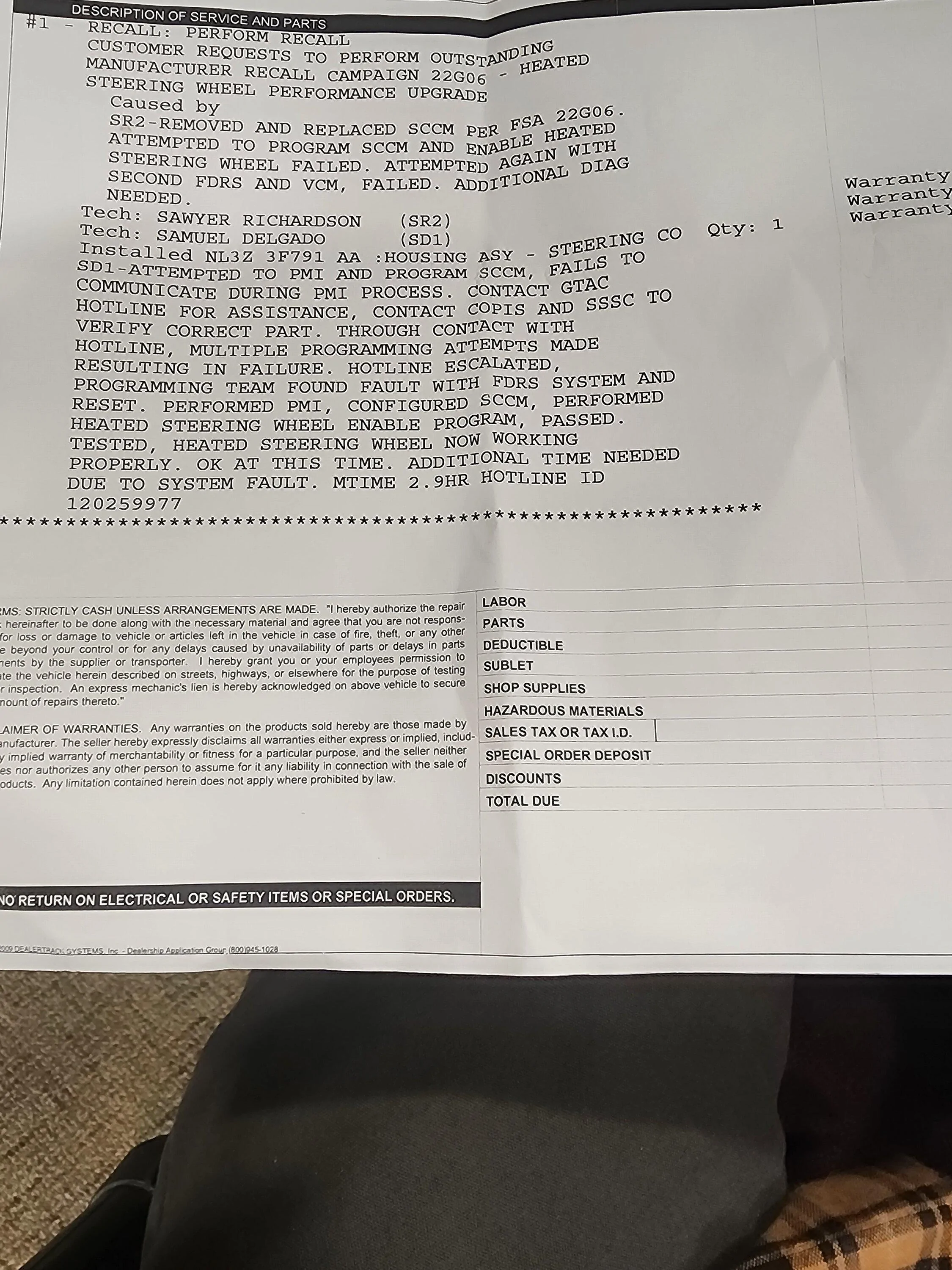

FINALLY!
Heated steering wheel is operational and it was nice this morning(35F).
Something wrong with the Ford Laptop software or something.
Dealer had truck simce the day after thanksgiving..
