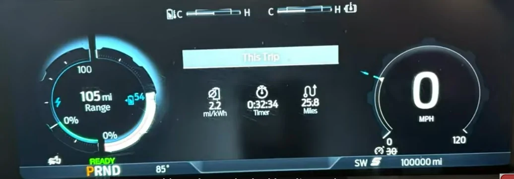

I watched a youtube video, the guy had over 100k miles but didn't know how to figure out the SOH...
From the numbers on his display I calculated it at about 90%, so seems the batteries hold up pretty well:
Ford F-150 Lightning Higher Mileage Lightnings 100k mile lightning Pro
Based on the 105mi estimated range, 2.2 mi/kWh and 54 percent SOC on the dash display, and assume a basic Pro with the 98kWh SR battery, this guy's battery is at 90% or so SOH at 100k miles.
105mi / 2.2mi/kWh = 47.72kWh
47.72kWh / 54% = 88.4kWh at 100% charge
88.4kWh / 98kWh x 100% = 90.2%
Age will take a percent or two off every year on average, DC charging some amount as well as deep discharge and charge, so they say.
