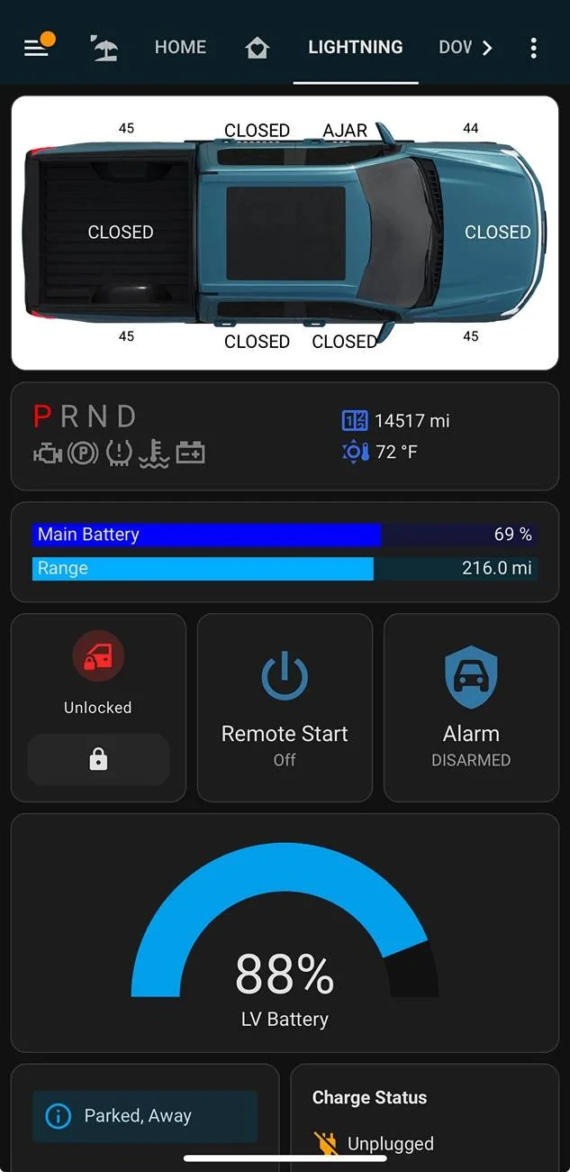

Kinda went a different direction, still using a picture elements card up top, but I spread a lot the info around to some other cards to keep it in a similar theme to the rest of my dashboards.
hey, could you post the entire dashboard yaml and the assets ? I have tried my own image but the picture elements are all misaligned . I am not very familiar with this card type so I have been struggling with getting it fixed... Curious if its my image size or something that might be a factor ...
johndyer
john
Oct 13, 2024
milton, ga
2024 lightning Lariat
Attached. Let me know if any questions... To be honest I have never checked to see if the PRND gear status works, but the code is there to change the color of the active gear letter.
The indicators do work, it's telling me my 12v is pretty low at the moment.
I feel like the image file itself is just as important at the yaml...

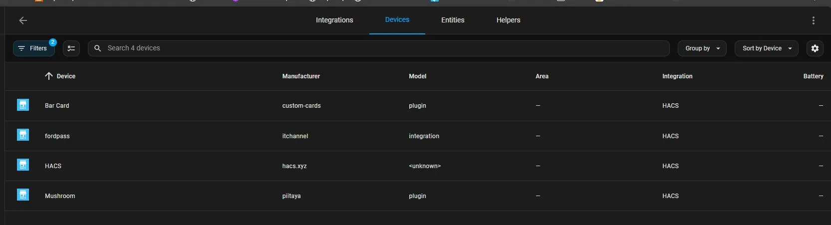

Anyone having any luck getting a new instance of the integration working on HA? Is anyone working on the integration? Last checkin appears to be 8 months ago...
zinkscott
Christian
May 16, 2024
63
40
2023 F-150 Lightning Platinum
Cloud Engineer
I set mine up about 2 months ago and it’s been working fine.
You must clear out any downloaded version via HACS and then manually install 1.70 per repo instructions.

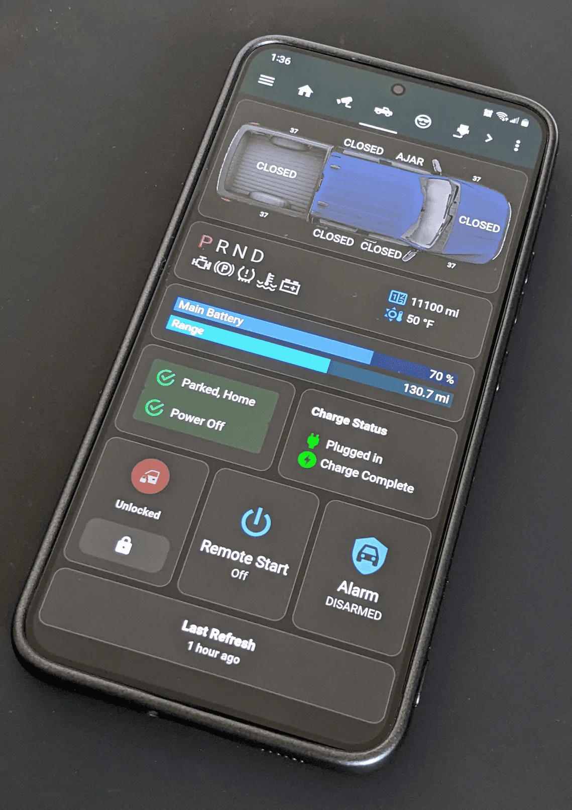

Very nice. I installed it last night and got it working. Would you mind sharing your dashboard?
FLSpartan04
Daryl
Mar 10, 2024
181
220
23 F150 Lightning XLT ER
Sure, considering I "borrowed" it from earlier in this thread. Just has some light modifications. Make sure to install mushroom buttons and bar cards in HACS:

- type: markdown
content: >-
{% set gearstatus =
state_attr('sensor.fordpass_speed','gearLeverPosition') | string
{% set ignitionstatus = states('sensor.fordpass_ignitionstatus') |
string %}
{% set trackerstatus = states('device_tracker.fordpass_tracker') |
string %}
{%- if gearstatus == 'PARK' -%}
{%- if trackerstatus == 'home' -%}
<ha-alert alert-type="success"> Parked, Home </ha-alert>
{%- else -%}
<ha-alert alert-type="info"> Parked, Away </ha-alert>
{% endif %}
{%- else -%}
<ha-alert alert-type="info"> Driving </ha-alert>
{% endif %}
{%- if ignitionstatus == 'OFF' -%}
<ha-alert alert-type="success"> Power Off </ha-alert>
{%- else -%}
<ha-alert alert-type="info"> Power On </ha-alert>
{% endif %}
- type: markdown
content: >-
<b>Charge Status</b>
{% set iconcolor = 'red' | string %}
{% set plugstatus =
state_attr('sensor.fordpass_elvehcharging','Plug Status') | string
{% set chargestatus =
state_attr('sensor.fordpass_elvehcharging','Charging Status') |
string %}
{%- if plugstatus == 'CONNECTED' -%}
<font color="Green"><ha-icon icon="mdi:power-plug"></ha-icon> </font> Plugged in
{%- endif -%}
{%- if plugstatus != 'CONNECTED' -%}
<font color="orange"><ha-icon icon="mdi:power-plug-off"></ha-icon> </font> Unplugged
{% endif %}
{%- if chargestatus == 'COMPLETED' -%}
<br> <font color="green"><ha-icon icon="mdi:lightning-bolt-circle"></ha-icon></font> Charge Complete
{%- endif -%}
{%- if chargestatus == 'IN_PROGRESS' -%}
<br><font color="royalblue"><ha-icon icon="mdi:power-plug"></ha-icon></font> Charging
&nbsp;&nbsp;&nbsp; &nbsp;&nbsp;&nbsp;{{(((as_timestamp(state_attr('sensor.fordpass_elvehcharging','Estimated End Time')) - as_timestamp(now()))/60)/60) | round(2)}} hours left
{% endif %}
columns: 2
- type: custom:mushroom-entity-card
entity: sensor.fordpass_lastrefresh
layout: horizontal
tap_action:
action: call-service
confirmation:
text: Confirm Refresh Data?
service: fordpass.refresh_status
target: {}
hold_action:
action: more-info
double_tap_action:
action: none
fill_container: true
icon_type: icon
icon: mdi:refresh
