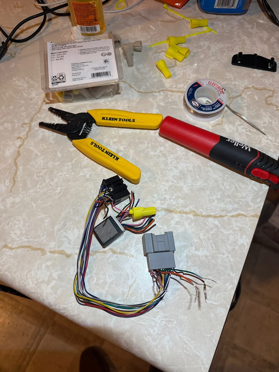

Reverting my poor harness back to the OBD-C original location while I wait for my new harness from Comma since I have the coupler now 🥴
I’m getting better at soldering and this wiring stuff though which is good.
Question - is the coupler supposed to work on just normal power or does it need the expected voltage from the truck? Neither the comma or anything else turns on or charges using it in the middle of any 2 USB-Cs. I’ve tried plenty of verified 3.1 Gen 2s of different sizes and using the stock comma angled short cord on the last mile. No device or the comma gets power
Want to rule out a possible faulty coupler as I’m doing this wiring cause I’ll order a new one if this isn’t expected, but I reckon Ill find out in the next few days when I try to connect it all up anyway haha

Oh and I’m soldering the wires and just super gluing the screws on 😉

If I am following correctly, you're asking if the Comma will power on if you add the coupler to a USB cord that is plugged in to a USB power source like a phone charger, not the truck?
Correct. Like using it in my house. I thought it should work so I was trying to test but no dice. I’ll admit I’m not too versed on resistors. But yes -
MacBook brick → any USB-C → coupler → Comma stock short cord → Comma = no power
brick → any USB-C → coupler → Comma stock short cord → iPhone = no power
brick → any USB-C → Comma = power. Etc etc
I tried other bricks of various power output too
Afaik it needs to be a 'dumb' power supply like what a raspberry pi 4 had to use since iirc it doesn't use the actual USB spec.
Note: I've never actually tried this, and is an educated guess.
Edit: You only need the resistor/coupler for communication with the truck. You won't need it in the house.
Edit 2: The 'dumb' power supply will likely also need to supply 12v on the line and not 5v.
Agree with everything @chriserx said except for "Edit 2". You can use a 5 volt USB when powering the Comma outside of a vehicle, you just have to accept the low voltage warning on the Comma. I have found that the Comma works best when connected to my powered USB hub on my desktop, but YMMV. Some USB power sources just won't work or will allow boot up but then the Comma shuts down.
When in the Lightning, you need the coupler with the resistor to prevent "CAN reflections" which cause the startup errors (I have no idea what this is, it's just what I've been told). The coupler has to be in the correct orientation as marked on the coupler itself. It can be installed anywhere along the USB lines.
The OBD power that plugs into the Comma harness is optional and is used to keep the Comma powered after you turn off the ignition. Use the OBD at your own risk with the Lightning's tiny 12 volt battery.

The coupler was not designed to be used with a 5v power supply. It was tuned for 12v in the car, I would expect weird things to happen on a 5v source.
