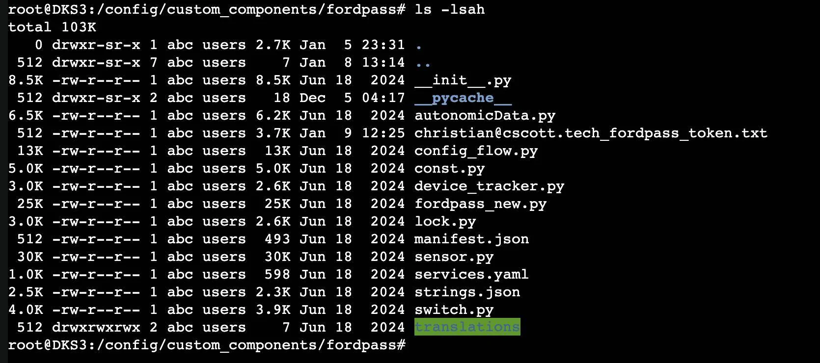

Did you just scp into your backend files and copy 1.70 into some specific folders? Didn't see specific instructions on the manual install.
2,832
4,028
IIRC I just downloaded the files from the GitHub site and then overwrote the same files on my HA box but keeping my existing token file there.
\config\custom_components\fordpass
Thanks I'll try poking around in the container later.

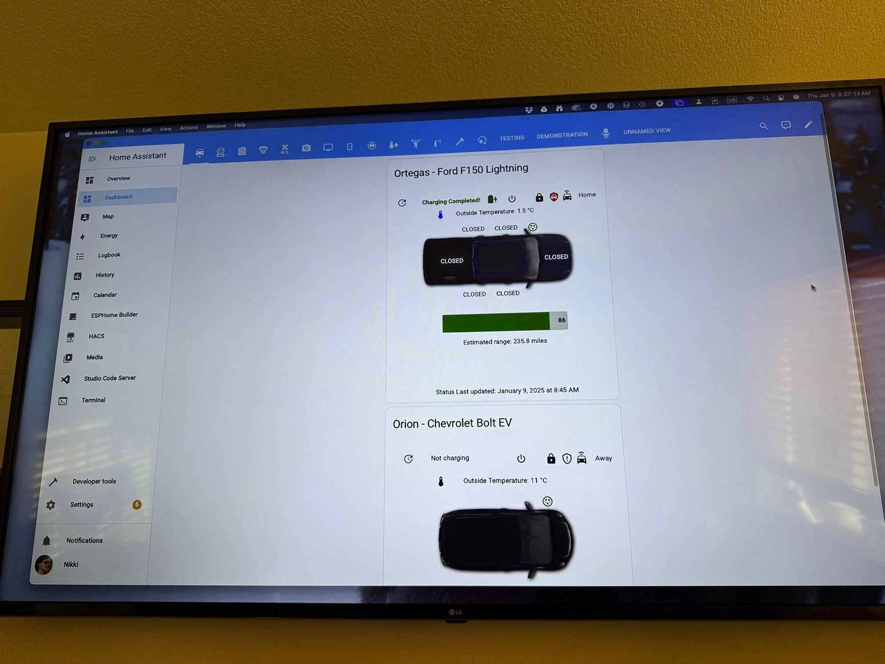

To add my voice back into this - sorry -I've been avoiding social media and forums of late because... *things* - I'd note that this integration does now require you to do a little leg work to keep it working.
The GitHub is pretty clear now - https://github.com/itchannel/fordpass-ha - but I would advise if you're anything like me to read it a few times before you try anything, otherwise you will end up scraping your head and screaming.
My system has been working with V 1.70 for literally months now and it's great. I don't have a very frequent refresh interval on purpose, because really what I use this for is remote starting of our Truck on a cold morning or hot afternoon.
We also use it to pipe info to our smart display switches so we can see at a glance how much range each of our EVs have (my bike hasn't got telematics... sad face)
Ford F-150 Lightning Home Assistant - Ford F150 Lightning Dashboard. IMG_7112

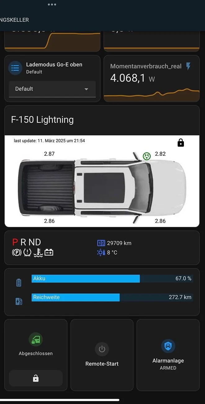

Got my integration working today as well. Thx for the valuable input from here. Used the repository marq24/ha-fordpass to install the branch via HACS (does not require copying files).
My Dashboard right now looks look that way:
Ford F-150 Lightning Home Assistant - Ford F150 Lightning Dashboard. IMG_0441
