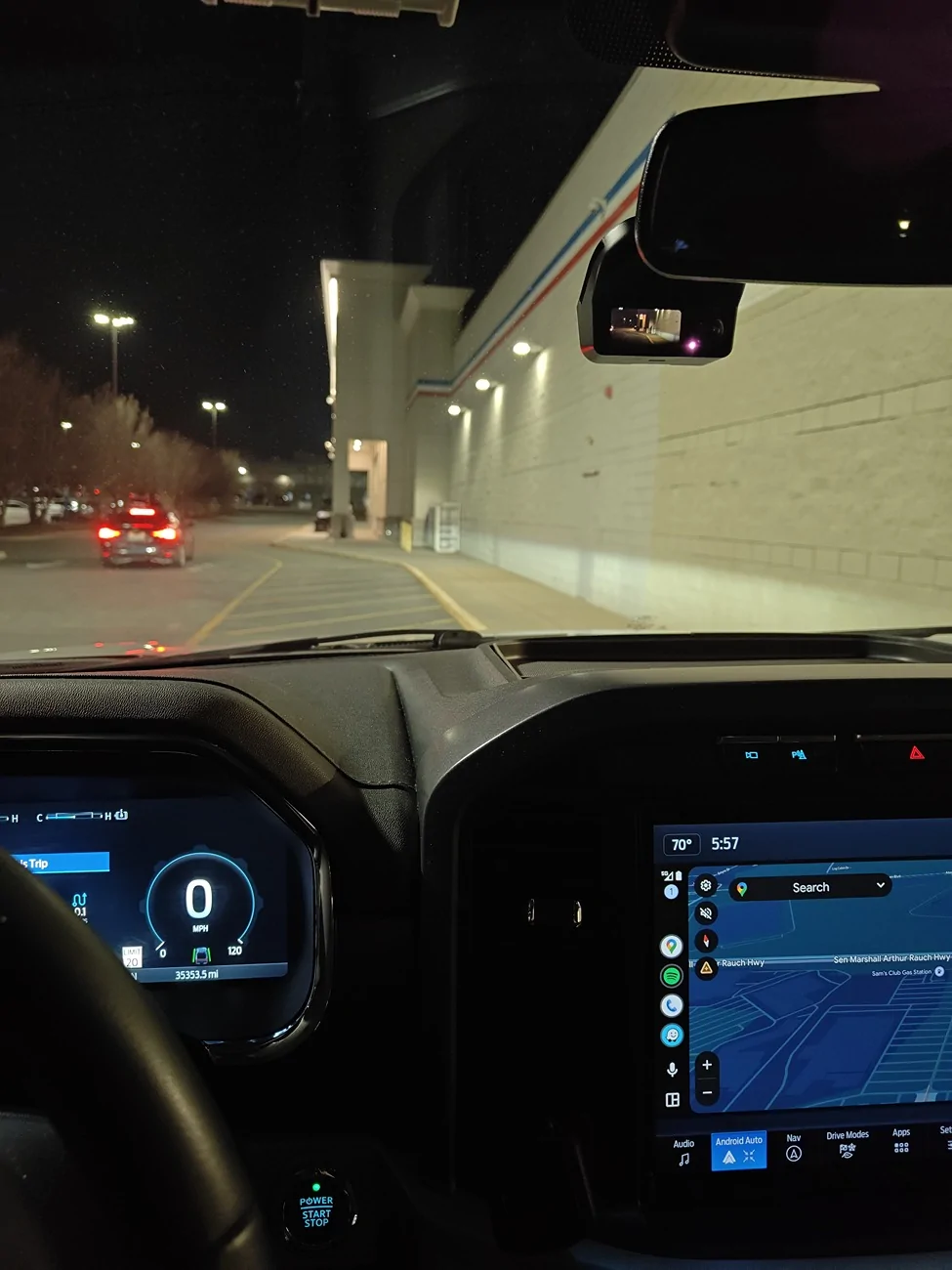

I got my Comma 4 last night @Ajzride was a huge help and great resource. It's amazing I'm super happy with it as a first time Comma user.
Ford F-150 Lightning Comma AI self driver assistant 1766012242628298714943676793461
