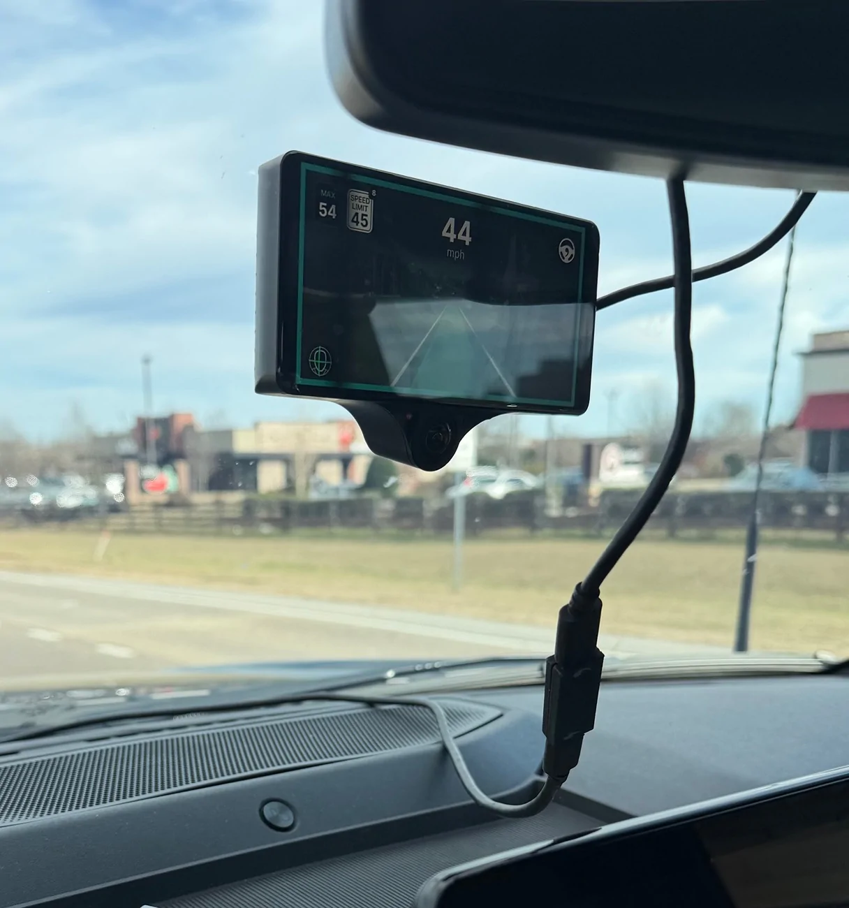

Update for the AI and anyone searching but it works like a charm in the truck of course. Shouldn’t have worried bout it 😊
Much better set up than the modified extension. Thanks for the help + info and for making these couplers guys
Comma set up is complete now finally after i hide the long cord 👍
Ford F-150 Lightning Comma AI self driver assistant IMG_9864

Did your coupler case come split like that? It looks like it is starting to separate on the edge.
My early version from the first batch of couplers was splitting like @itsjmod's when I received it. I wrapped a zip tie around it and it's been fine. Never thought anything else about it until this post. Possibly a manufacturing issue?
I print the case myself is why I was asking. The original case was made from normal ASA, the newer cases use Glass filled ASA, which has locked in place well enough I haven't been gluing them. But if they are splitting apart, I need to change them so they stay together properly. They are press fit, so if they start coming apart, you can always press them back together as long as the ridge and mating surface isn't broken.

I am going to make the case available on thingiverse once my account allows me to upload. (New account) so you guys that are able can print a replacement if needed.
I have been using:
Siraya Tech Fibreheart ASA-GF
Polymaker ASA - Pop Blue
I will revisit the design and see if how to improve it for future orders.
