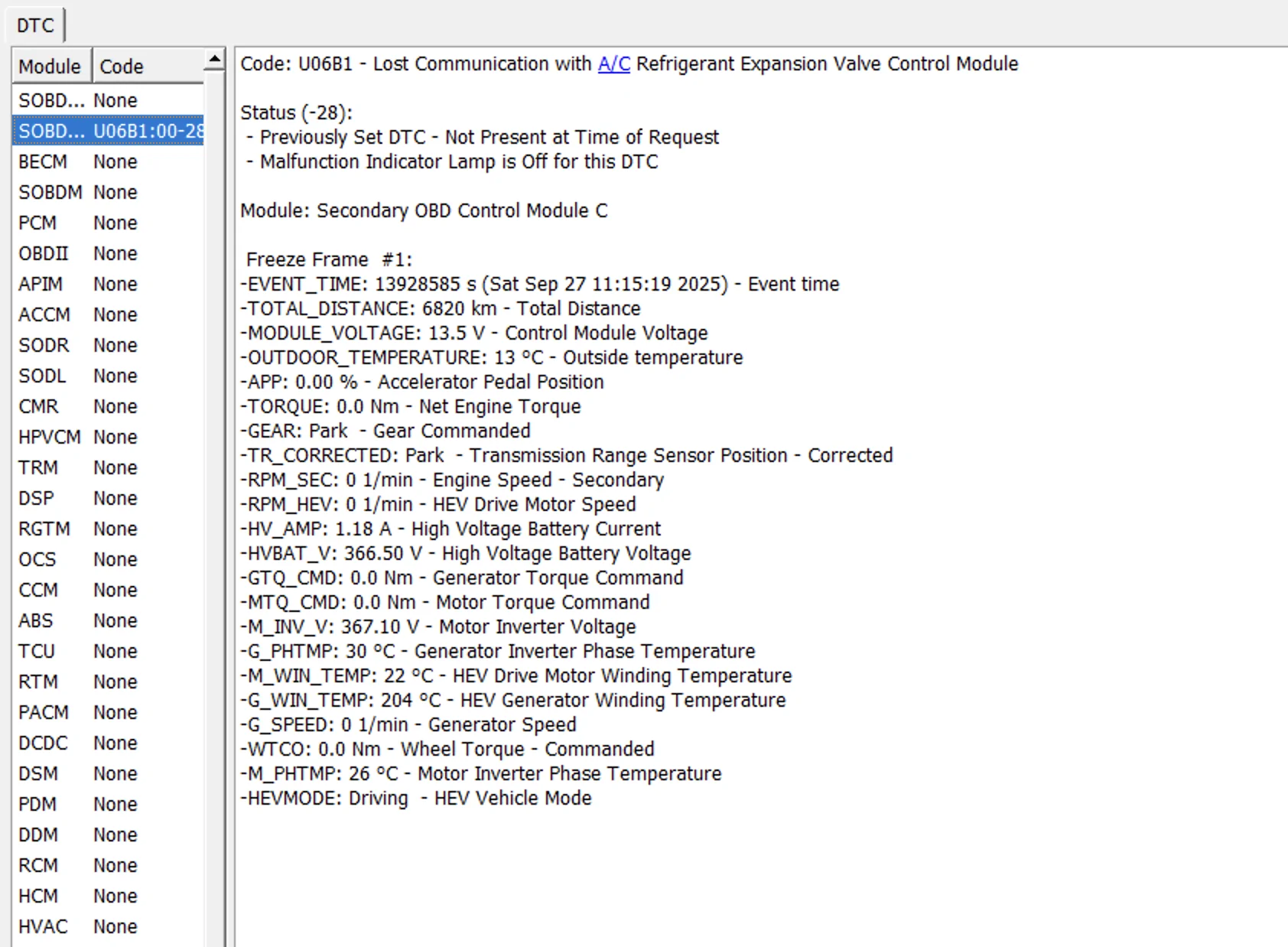

Have had this running the CommaAI on my 24 Lightning Flash for several months and probably 15-20,000 km......but today showing this :( Anyone come across it before?
Usually a bad connection somewhere. Does it continue after reboot?
I haven't tried yet - I will try tonight. If it fails I may need to order a stock harness and hit you up for a a resistor :) This is using a modified harness.
I have heard of a decent amount if intermittent issues with the modified harness. I dont have much experience with them personally, so I cant say for sure.
You can always try a different usb C cable before you spend the extra for a new harness, but it would be odd for a USB C cable to suddenly go out unless its under a lot of stress.
