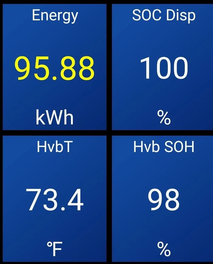

I use OBDII and it has helped me understand a bunch of things but still confusing on others. For example SOH of 98% makes sense when you divide 95.88 KWh by what the capacity was when new (98KWh usable)
Ford F-150 Lightning How Much Battery Capacity And Range Has My Ford F-150 Lightning Lost After 3 Years and 38,000 Miles? Screenshot_20250905_002252_Gallery

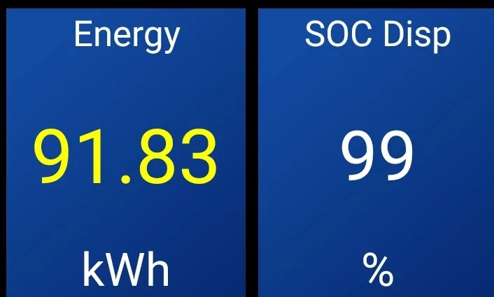

But on the other hand you would think 99% of 95.88 KWh would be 94.92 KWh not 91.83 KWh
Ford F-150 Lightning How Much Battery Capacity And Range Has My Ford F-150 Lightning Lost After 3 Years and 38,000 Miles? Screenshot_20250905_002311_Gallery
The gap widens as you go down and shrinks again as you go lower. It looks like Energy is the usable energy and displayed SOC should correspond to that.
In short, I don't blame you for staying out of it but I would watch any youtube posting on it if you didn't.

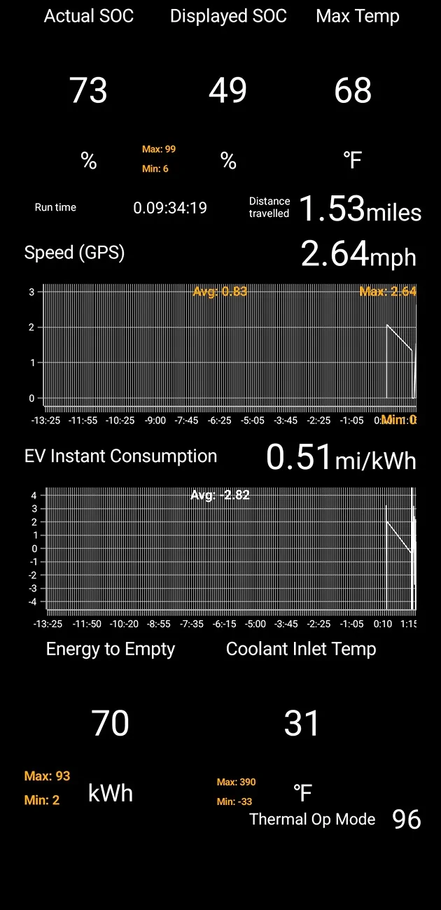

SOH can vary by several percent from one minute to the next so I dont pay much attention to it. It is pretty handy though since you can customize the pages and even record/export data.
General driving screen (just running in demo mode)
Ford F-150 Lightning How Much Battery Capacity And Range Has My Ford F-150 Lightning Lost After 3 Years and 38,000 Miles? 1000011010

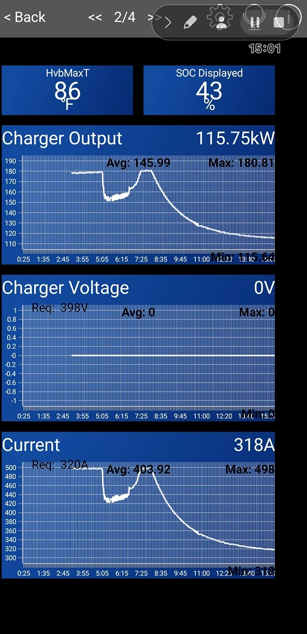

Charging screen. Can see what the truck is requesting v what it's receiving. This was when i got derated on a supercharger. (Had the wrong value for voltage which is why it shows 0 but has since been adjusted)
Ford F-150 Lightning How Much Battery Capacity And Range Has My Ford F-150 Lightning Lost After 3 Years and 38,000 Miles? 1000008869

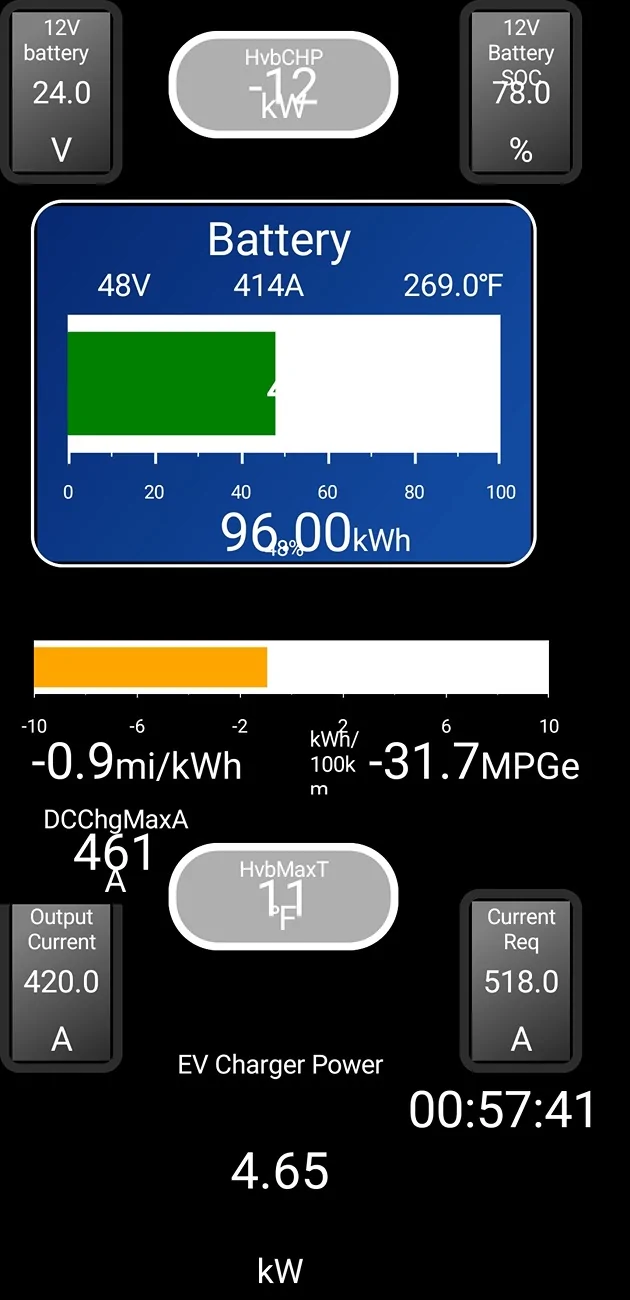

Updated charging screen in demo mode
Ford F-150 Lightning How Much Battery Capacity And Range Has My Ford F-150 Lightning Lost After 3 Years and 38,000 Miles? 1000011011
