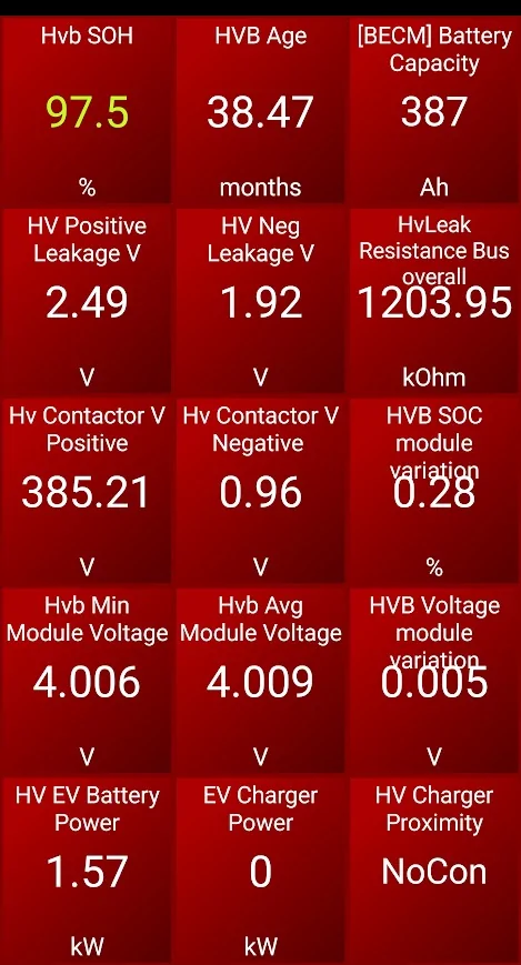

I used car scanner for the first time today, this is my Soh [97.5 %] after 3+ years at about 88% Soc

I'd like to see that kind of info. What scanner and model did you use to see that data ?
Veepeak OBD CHECK BLE+ Car Bluetooth OBD2 Scanner
Android version of Car Scanner app.
