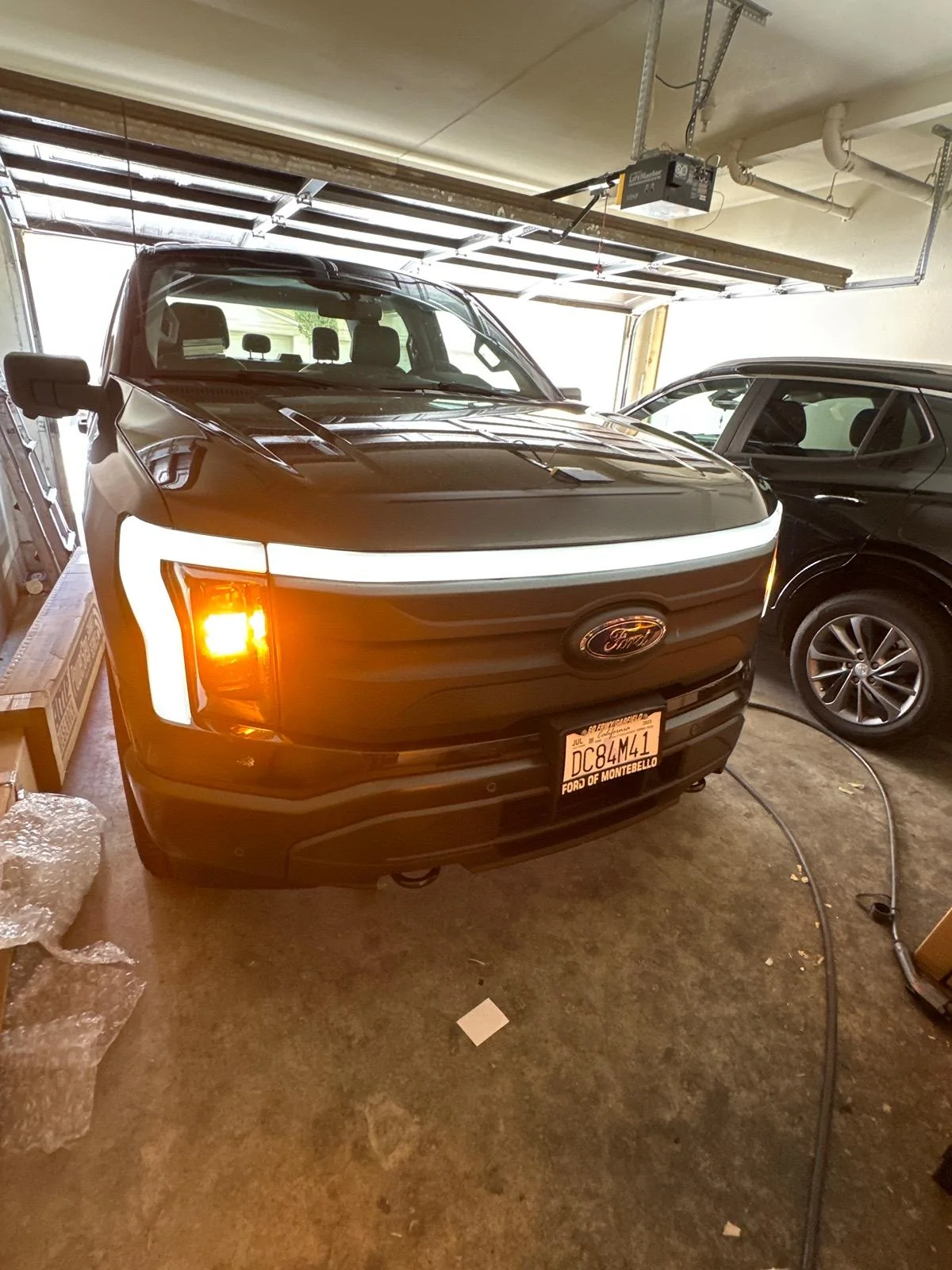

Ford F-150 Lightning How To: Front Light Bar on Lightning Pro imag

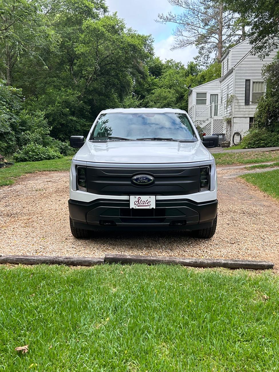

Added mine to the list of Pros with light bars. Thanks again to @shoopg and @KurtsRPMGarage for the help with this!
The first light bar I bought off eBay didn't work due to a missing pin. I was able to return it and get a refund no problem though. Second light bar I bought worked perfectly.
Ford F-150 Lightning How To: Front Light Bar on Lightning Pro IMG_0879
Ford F-150 Lightning How To: Front Light Bar on Lightning Pro IMG_0882

Looks sharp in white!

Agreed! Some think the oxford white is boring but I personally love it. I mean, my preferred color would have been iced blue silver but for some reason Ford discontinued that color for the 2023s.
