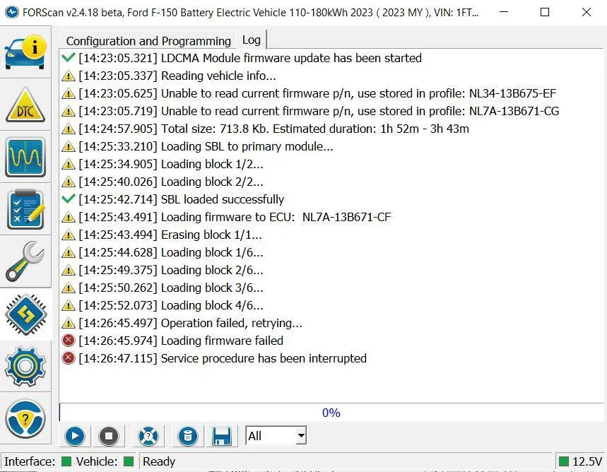

HELP! I ran into some issues during the firmware upgrade and now my driver's side headlight doesn't work. The firmware seemed to be installing fine until it hit an error "Loading Firmware Failed" and "Service Procedure has been interrupted".
I attempted to install the firmware again, but when I select the "LDCMA Module firmware update" in forscan, it says the following:
Unable to identify the Module
FORScan was unable to indentify this module, but found some compatible assemblies by hardware number.
And I can select the following:
NL7A-13B626-CG
NL7A-13B626-DG
Not sure what to select and risk making things worse... Any help is much appreciated!
EDIT: Looks like it would be the CG module. If I load my profile, it finds it stored in my profile and I am able to upgrade the firmware. Unfortunately, each time I upgrade, I get the same result. I've attached a screenshot here.
SOLVED! It was the OBD2 Scanner I was using. I was using the ELM327, which isn't fully supported by forscan. When using a supported scanner, the firmware upgrade went through without any issues!

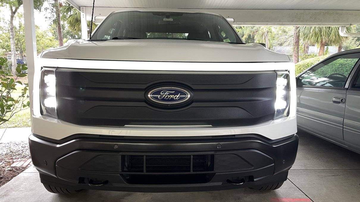

It depends how well the headlights and/or hood align relative to the fenders. You may have to loosen them and adjust their positions as well. But there is some wiggle room with the light bar mounting holes.
Fortunately for me, my Pro lined up satisfactorily by only adjusting the light bar position..

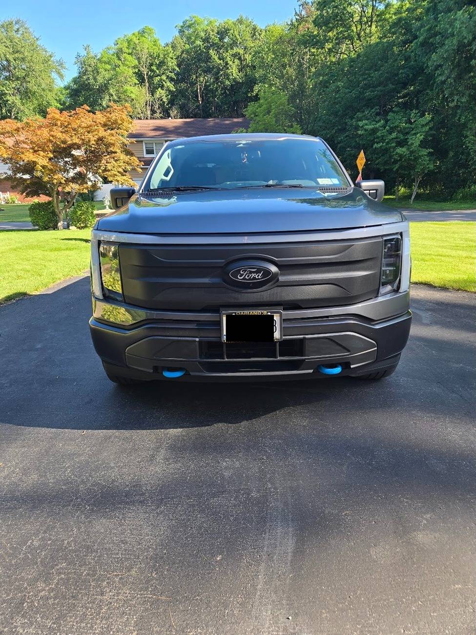

I used plastidip to put a thin strip on top of the lightbar. My hope was to add some depth instead of making look like a thick piece of cheap plastic. It ended up looking like a cybertruck wannabe though and not the look I was going for, so I have since removed it. Here is what it looked like with it on though:
Ford F-150 Lightning How To: Front Light Bar on Lightning Pro 20250702_084023
Ford F-150 Lightning How To: Front Light Bar on Lightning Pro 20250702_213718

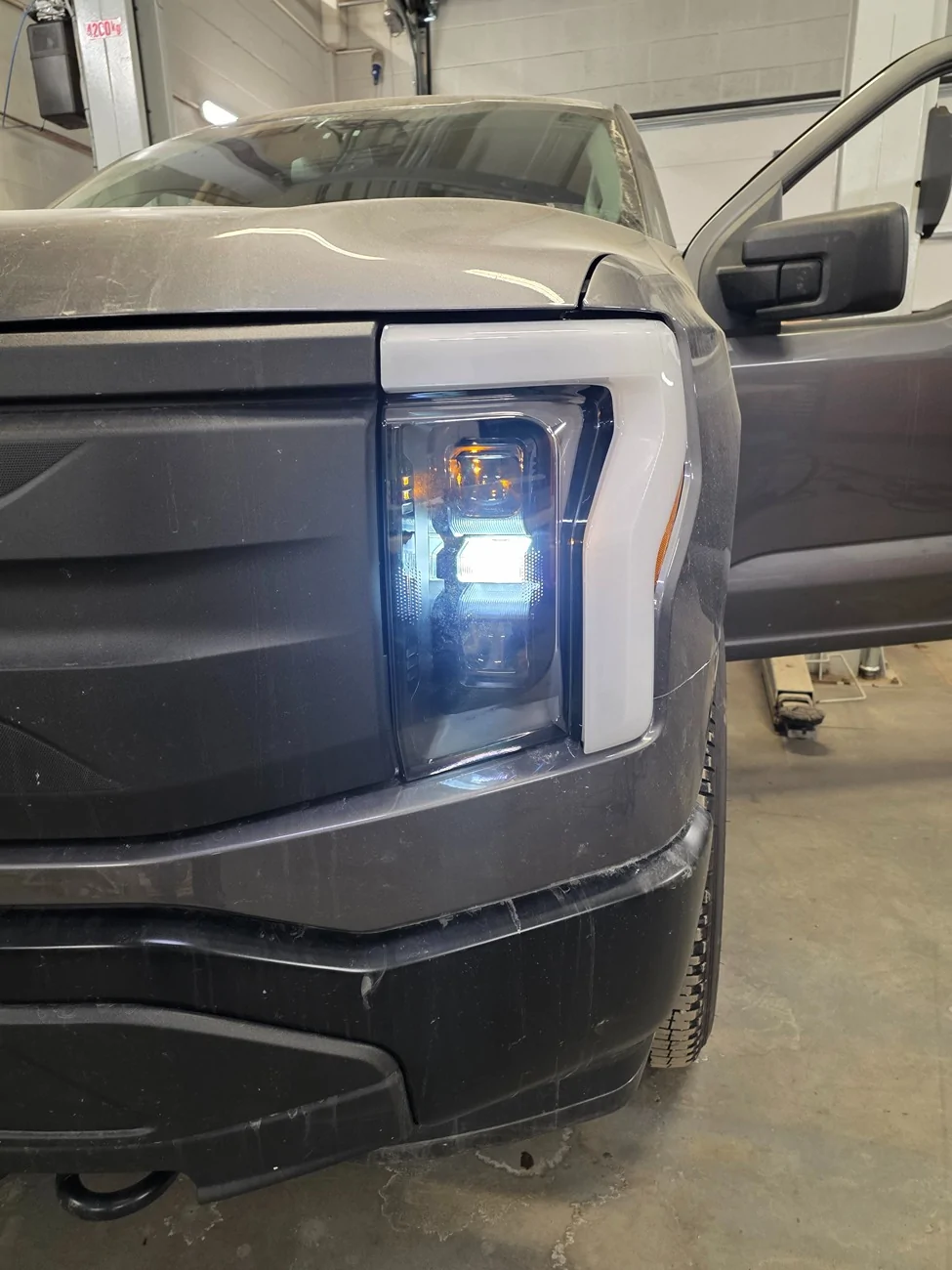

Does someone have a back-up of the firmware for LDCMA without the Light Bar? My car seems to have the Light Bar firmware installed in LDCMA, so my left DRL is not lighting up and I have a code for an open circuit for the signature lamps. I have a PRO btw, no light bar from factory.
Ford F-150 Lightning How To: Front Light Bar on Lightning Pro 20260219_152311
3,113
4,456
I'm a little confused. In your pic, the small rectangular light that is brightly lit is the DRL. Are you referring to the plastic light bar shaped like a "7".
I see you're in Europe. Did you have any reconfiguration work done when you imported it?
