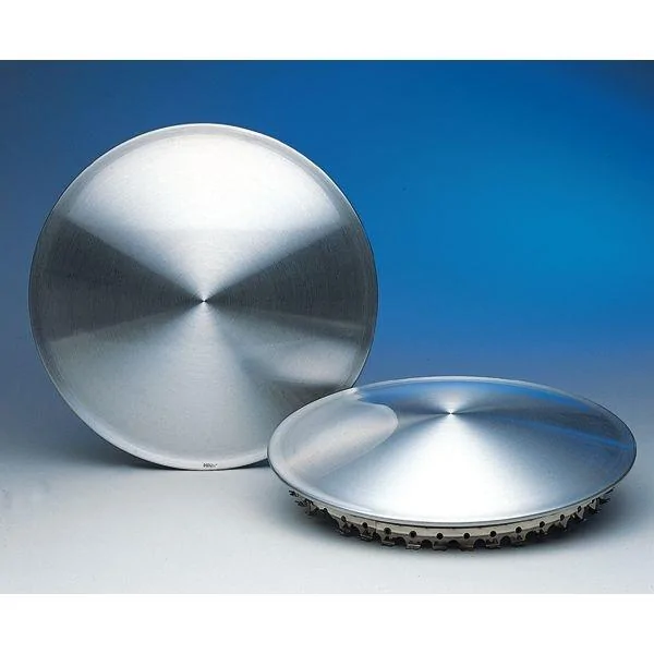

Tesla Cybertruck did it; is it worth it for the LER? They don't look too bad either. I saw a report where you can see there's a lot of drag produced at the wheels. I was wondering if hubs would help reduce that.
The reason for this is I was wondering if there's any way to try and offset the drag and range loss of a leveling kit and 33's, by purchasing lightweight racing wheels. The stock weight is about 78lbs? The racing wheels would be about 38lbs in 20's.
Alternatively, I wonder if they'd be useful for long trips, as I do a lot of highway driving.

I think weight is only really an issue when it comes to overcoming inertia, once you're at speed on the highway, aero is the biggest factor. So if the racing wheels + hubcaps have better drag coefficients than the stock wheels, then yeah, it would be useful, but I wouldn't know how to test/calculate any of this without just trying it. If you got the money, do the experiment and show the differences it makes. preferably with hundreds of miles worth of sample data with each set of wheels.
I wouldn't mind throwing hubcaps on for road trips, and taking them off when running around town. Actually seems like it would be a great compromise.

Huh... this seems like a problem that deserves a solution, or two. 1) How tough could it be to create a plastic hubcap that clips onto the existing wheel and improves its aero performance? As someone who drives his Lightning at highway speeds A LOT, I would pay for a simple mod that gave me 4%-8% more range at 70 mph. 2) More difficult, but still worthy, would be a wheel that combined lower weight with great aero. I know from decades of bike riding that rotating weight matters; as one previous commenter said, it is just physics. Hey aftermarket guys - tune in!

The heavy trucks have a bolt in flat wheel cover design. I was excited about, until I priced them.

The Lariat wheels (also on the XLT ER) are pretty aerodynamic as is. I don't think a hub cap is going to improve anything. Lighter wheels would make a much larger difference, but not sure how much without considering the whole wheel/tire combo in terms of mass and aero.
All things considered, it's a pickup truck and has the aerodynamic prowess of a brick. Also why the ugly ass Cybertruck can have a slightly smaller HVB than the Lightning ER, larger more aggressive AT tires and get about the same range. The angular stealth fighter front end has much lower drag at highway speed vs. the F150. As for the wheel covers, Tesla is having issues with them and is currently redesigning. Not sure how much they help vs. if they had just designed a more aerodynamic flat-faced wheel to begin with. And most wheels still require some degree of airflow to minimize thermal buildup around the brakes. Not as important on an EV with the regenerative braking. Could be a concern if you tow through the mountains regularly... Although, when you're towing, wheel covers are not going to make one bit of difference with all that drag behind you.
You'll probably gain more efficiency by lowering your average highway speed by 0.5 mph than any wheel covers are going to give you.
