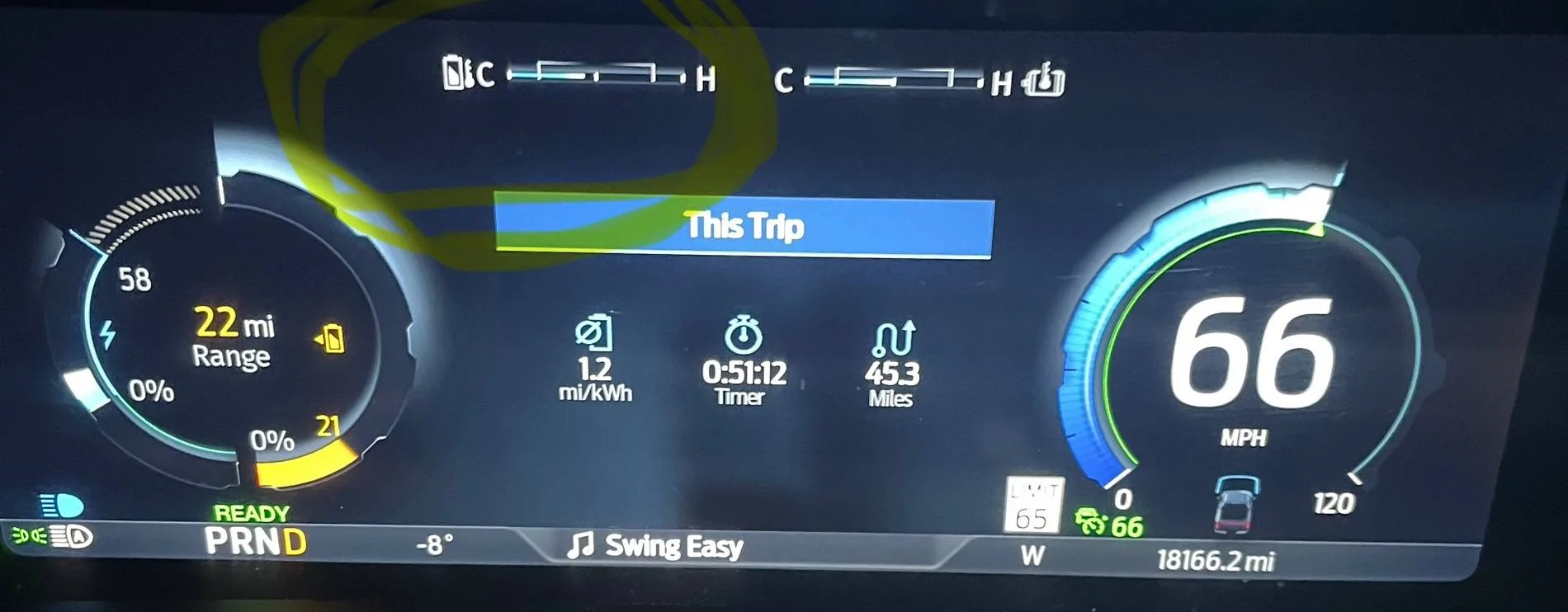

I know it showed 1.2 but with 21% charge and 22 miles of range there’s no way it was actually 1.2. (131x.21x1.2=33 still pretty terrible) I wish the kilowatt per mile was a live number, but it’s some average that doesn’t read real time. And I’ve said it multiple times in this thread. I could not be on shore power I was in a parking lot. Thankfully, taxman had an actual tip to get your battery to precondition off plug. But if you look at the picture from my first post, the battery temperature is not bad. Battery temp was almost right at temp and I still got this horrible horrible range.

This thread should have a “precondition” counter on it I swear seriously, though the battery temp itself wasn’t that bad (just below line). Look at the gauge again.
If the battery is using energy to warm itself it can't use that energy to drive. The temperature below the tic mark is a pretty good indication that the battery is using energy to warm itself. That's why people keep mentioning it!
You: my range isn't good.
People: you could increase your range by preconditioning.
You: that doesn't matter, my range isn't good.
I'm pretty sure that line is a random marking intended to keep owners feeling happy, not to actually tell you anything. And OBD reader and an app would be MUCH better.
In all seriousness though, your battery was probably "warm enough" in the garage to register as normal, but probably cool enough to trigger the battery heater. Then once you pulled outside the outside weather started sucking every btu out of that battery. It's highly likely that preconditioning would have warmed the battery up more than the garage temp and the onboard heater would not have to had work AS hard. Nowhere near as much energy as warming a stone cold battery, but still energy.
What is your speed and how are the winds?
Between 60 and 67 never over. Thankfully that night there was no wind. head wind would’ve had me driving 35-40 mph or less. But generally, the winds around here are straight line and over 20 so you’ve got bad wind One Direction good wind hopefully coming home as long as it hasn’t changed. But I’ve fought wind both directions before. I’m just that lucky.
This pretty interesting thread reminds me just how enormous our ER traction batteries are on the Lightning, in a relative sense.
Change to internal conditions of traction battery X takes time... change to internal conditions of a yuuuuuge Lightning ER battery takes that much more time and energy. Especially in weather which is sub-optimally hot or sub-optimally cold.

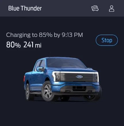

Yeah, she always lies to me when I’m above 80% too. once I start driving I’ll lose 80 miles or so after going 10 miles
37
3,802
6,930
Ford did that to satisfy the people complaining about their "range".

Any state of charge above 80% automatically defaults to EPA numbers, no matter the current or predicted conditions.
The numbers used to be spot on in the beginning.
So I feel like this may have changed recently. When I charge to 90% and it's been in the 20's to 30's at night, my truck will say my range is between 265 to 270. I have a Lariat ER so that equates to less than 300 miles. I remember when they did the 'feel good' mileage change to make people feel better. Almost feel like they did a compromise now, better than it actually is in the cold, but not full EPA. I'll have to see what I get next time I charge to 100%, see if it resets to 320.
