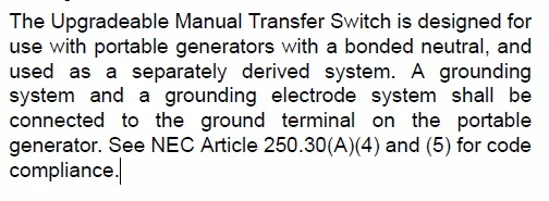

GENERAC transfer switch with a bonded generator - grounding requirements
The GENERAC 6853 transfer switch manual says about grounding requirements for use with a bonded generator as a separately derived system:
Ford F-150 Lightning I need someone to help me respond to this if possible. GENERAC grnd req cod
"...A 'grounding system' and a 'grounding electrode system' shall be 'connected to the ground terminal' on the portable generator. See NEC Article 250.34(A)(4) and (5) for code compliance."

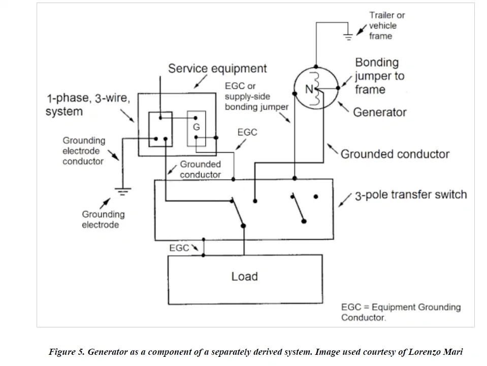

A recent figure by Lorenzo Mari, Figure 5 below, shows what is purported to be a system compliant with the recent NEC code (2023 version) where no additional nearby "grounding electrode system" for the generator is provided (no nearby ground rod to frame). Also note his bio at the end of this post.
Ford F-150 Lightning I need someone to help me respond to this if possible. Fig 5 house system is grounding system
The generator grounding electrode system is apparently the grounding electrode at the service equipment (panel).

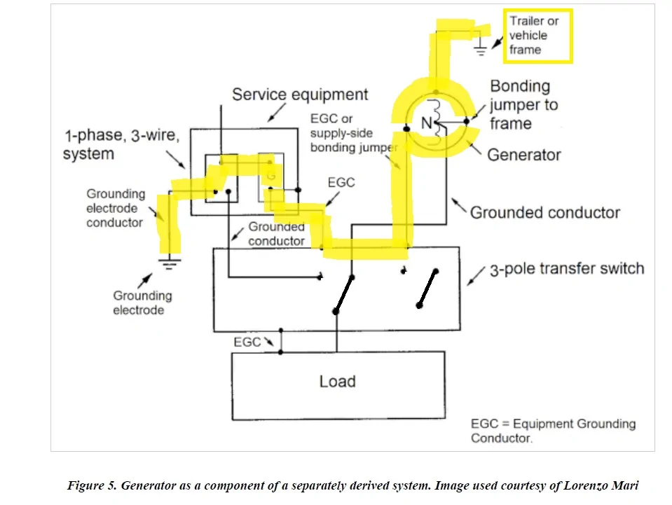

The "grounding electrode system" from the generator to the grounding electrode has been highlighted in yellow below (the transfer switch in the highlighted image is shown in the generator connected mode where the grounded conductor - neutral - is switched to the load and not directly connected to the utility neutral).
Ford F-150 Lightning I need someone to help me respond to this if possible. Fig 5 house system is grounding electrode system-path yello
But...
Regardless of Lorenzo Mari's Figure 5 and his expertise, if I want to provide a nearby grounding electrode system for the Lightning, where would be a good place to connect a grounding electrode conductor to the Lightning?
But...
By "good" I mean - easily accessible for connecting to a grounding electrode conductor (#6 wire) and making a good electrical connection to the Lightning chassis (generator frame).

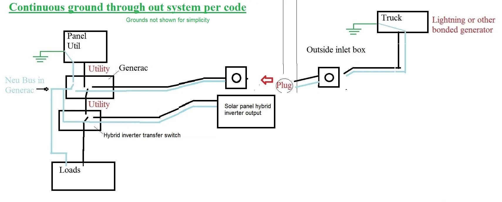

Sorry, but I did post how to do that in general terms I could have been clearer - review the thread and you will see.
I did something similar with my system because I already had a transfer switch wired for a non-bonded generator, that had to be bypassed when using the Lightning bonded generator through the GENERAC.
The issue of grounding came up as a result on my posting that block diagram and someone saying I hadn't grounded it - I had left off the ground wires for simplification, but then I posted a block diagram WITH the ground wires drawn in.
I think it could be a way to bypass the hybrid inverter system automatic transfer switch, but it would require some rewiring.
In simple terms, you use a GENERAC to switch between the Lightning and the utility, feeding the output to the hybrid inverter transfer switch system which switches between the utility/Lightning (output from the GENERAC output) and the hybrid inverter.
OK, so here I redrew it with the "solar panel hybrid inverter" output and labeled the second transfer switch the "hybrid inverter transfer switch":
Ford F-150 Lightning I need someone to help me respond to this if possible. Block diag of 2 xfer sw hybrid inverter
So the GENERAC manual transfer switch passes through the utility to the hybrid inverter transfer switch when in utility mode, but when the Lightning is connected and powered it can transfer to that source and pass it through to the hybrid inverter transfer switch.
The hybrid inverter transfer switch would switch between the solar panel hybrid inverter output and the utility/Lightning output from the GENERAC.
In the GENERAC, both the hots and neutral would switch between the utility and the Lightning hots and neutral. I gather that the hybrid inverter transfer switch does not switch the neutrals, only the hots, which is like my old transfer switch. I designed this wiring configuration because I did not want to unwire my old transfer switch and remove it from my basement wall (laziness).
That is the concept.
Sorry I didn't make it clearer by redrawing my system's block diagram, but here it is now.
