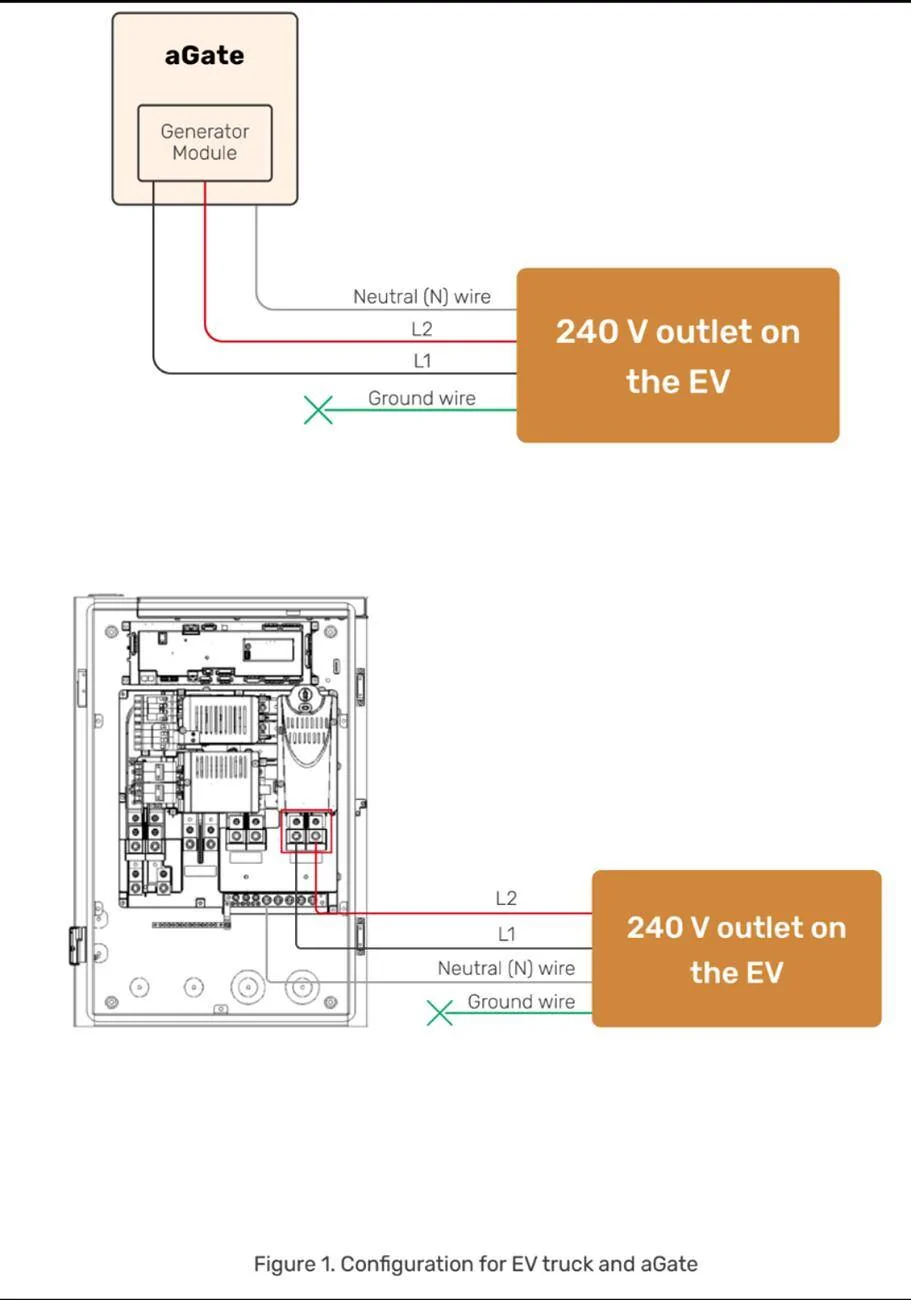

So what is the verdict?
It works!
They used a four-prong plug with neutral and ground separated. Landed the aGate ground in the box.
Have a feeling this is what Franklin is advising all around. But, I don't know.
I'm just glad it works.
Putting in a whole home surge protector.
The Whitepaper is downloaded here: https://f2h.io/rups7h9w0fr2
Ford F-150 Lightning I need someone to help me respond to this if possible. 1000012889
From the Franklinwh Whitepaper.

What they likely didn't tell/show you is that they disconnected the ground from the truck.
That’s the easiest way to get around the ground fault. That’s what lots of us who have the powerboost have done. And now with my lightning that’s the same setup I have although now I have a whole house generac so not much need but it’s nice to have a backup for the backup.
Yep that's the most practical solution but you might trigger another reminder from someone on the forum about not being code compliant and the safety risks of disconnecting the ground.
Oh I’m sure the electric Karen’s will go nuts but the bottom line is that the system is still grounded. And the trucks system is sensitive enough that even without the ground of it senses anything off it will still trip the breaker.

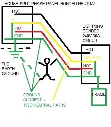

Imagine you cut the ground wire and aren't using a neutral switching transfer switch, then the driveway or yard ground is wet and you or you child touch the truck when there is neutral current present...
Ford F-150 Lightning I need someone to help me respond to this if possible. 000-NEUTRALS bonded IN 2 PLACES-path through you

Well that took way longer than I thought it would. Yes well aware of all of the above. I operate generators in the entertainment industry. My point only is that the truck is kind of a unique case because of how it operates and is quite sensitive. Could you possibly get hurt? Sure.
Not that I’m advocating anyone test this. But I have a sneaking suspicion if your example above even tried to happen the trucks electronics would shut it down in a second if it sensed current running on the neutral. That’s my point is that the truck is a lot smarter than we might think it is. We have rules in place and that’s a good thing but common sense and a little street smarts also goes a long way as well.
I don't quite see where this is accurate. How exactly will current kill this human where it would not have already tripped a breaker by following the neutral back to the source?
Can you draw the fatal current path here?

Yes the GFCI should trip after sensing the current change in the neutral, however that would be AFTER someone gets a shock.
Imagine grand-dad or grand-ma with a pacemaker or someone with an underlying heart condition...no shock is a good shock.
There are other scenarios beside the one I made a drawing of. The NEC is there to protect people and property in case something goes wrong - an open neutral for example.
General rule is always have a continuous equipment ground. And always follow the code - the life you save may be your own.
The path is through the human to the Lightning chassis. The GFCI tripping will keep the human from becoming burnt toast, but they will still get a shock.
Suppose the person who gets the shock has a pacemaker or a weak heart.
Suppose the person is wet and barefoot from a dip in the pool - their resistance is low and the current through them will therefore be larger.
Bonded generators powering dwellings require a GFCI protected outlet, a neutral switching transfer switch and a nearby earth ground, as well as a continuous equipment ground through the system.
The Lightning is a bonded generator. This video explains the NEC code for bonded generators. OSHA also requires the ground.
How exactly do you propose that happens when the chassis is isolated from ground by the rubber tires.
