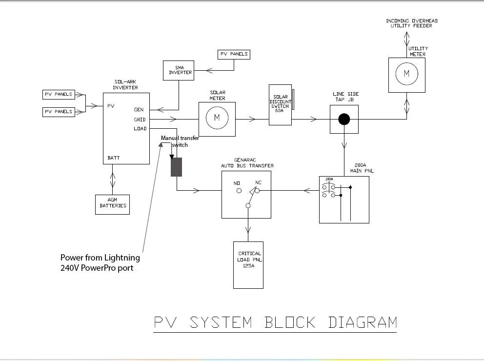

I am going to get this blessed by someone who knows what he is doing. But from what I've seen on this forum there doesn't appear to be any reason it shouldn't work. It would seem to be equivalent to just taking my inverter out of the picture and directly connecting the Lightning to a critical loads panel, which a bunch of people have already successfully accomplished.
Are there any Ford Lightning warranty issues connected with using an appropriately chosen and placed manual transfer switch in a circuit connecting the 240V power outlet to a critical loads panel?

Just got off the phone with Sol Ark. The rep said a manual transfer switch would NOT work. If I understood him correctly (I am about as far from an electrician as you can get!), the problem is that both the Sol Ark and the Lightning are neutral-bonded. The position of the switch doesn't matter because there would still be wire connectivity between both the Sol Ark 'Load' breaker and the Lightning battery.
If I got this right, the only way to use the Lightning's battery without an HIS is establishing completely separate circuitry. (Is this why you can't have an HIS and a legacy inverter online at the same time?) It appears that a number of people have successfully connected their Lightnings to their home power grid. Short of installing an HIS, is there any way to emulate their success while preserving a legacy PV system for day-to-day operations?
I met with an electrician for a site survey this week as well. He was similarly pessimistic about my ability to connect my home to the Lightning using a transfer switch or double-throw safety switch. He agreed with others here that if it were possible, the transfer switch would have to be installed completely independent of my solar array, solar inverter, Tesla Powerwall batteries, and Tesla Gateway.
He mentioned that a better approach would probably be to wait for new inverter technology to become available that allows a generator to be connected directly to the solar inverter and thus integrated into a solar power system. My impression is that this is what Sol-Ark is trying to do, but I'm not sure since I don't know much about them. Is any other inverter company (Enphase?) planning to release new inverter technology that would allow power input from a generator (or Lightning)?
I don't have Sol-Ark but based on your diagram, it seems If you use 3-pole (neutral) transfer switches in your diagram then it should be fine.

More conversation with Sol Ark. I mentioned "Neutral Switching" transfer switches like the Generac 9854 (50A) His reply was: "We're needing to confirm if this switch is just switching the neutrals? Or is it switching both the neutrals and the grounds?" If both, there may be a possibility connecting to the Sol Ark's 'gen' breaker would work.
It would be nice to come up with a generic solution, assuming this neutral-bonded / GFCI is a problem for all or most hybrid inverters - and then get it blessed by Ford. Ford's ties to Sunrun are sinking a powerful marketing pitch: 'a free truck and 10 Tesla Powerwalls for half (maybe now 2/3rds?) the price'
The Sol Ark *will* work with the Lightning on the Gen input so long as the Ground Pin is removed from the cable plug in from the truck.
